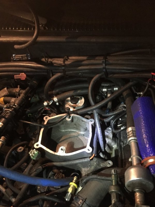

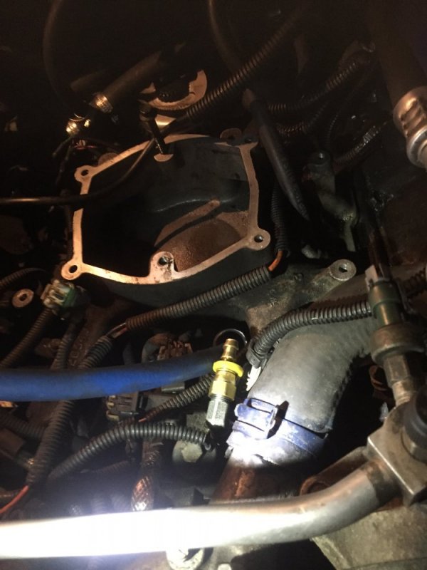

Ive been seeing even lower fuel pressures after I installed my new walbro frb-5 pumps. @Hink mentioned that he is running two lift pumps in series in his wvo system. I am contemplating plumbing one of my acdelco ep1000 pumps in after the walbro and the first fuel filter, so it´s closer to the fuel filter manager and gives a bit more push. Would this be a stupid idea? Could it put an extra strain on the walbros, or would it help them push more?
