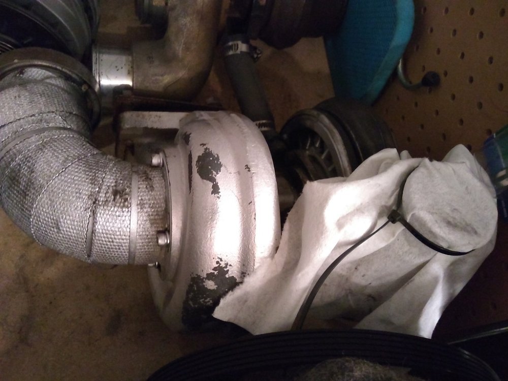

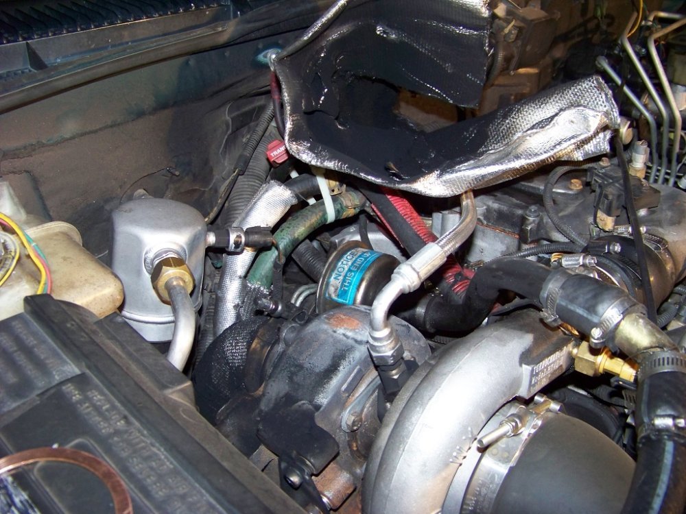

Any blanket that will cover the turbo will do. I used the custom fit ATT one in the day and then whatever I could find for the HX40II.
I also used header wrap paint on the wrap. That's high temp paint on the ATT.
