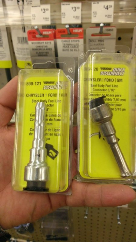

OK, got it up in front of the shop finally, and pulled the engine cover to give a bit more room to get to the back plugs, and noticed the smell of gas. Traced it to a leak at the quick connect of the high pressure fuel line to the fuel rail.
Is the seal and half of the connector serviceable separately, or am I looking at a new fuel line too? I don't have a lift, so unfortunately this one may get farmed out, or might do it on top of the car trailer where I can crawl under it easier. :)

You'll need a fuel line disconnect tool, and you can try to replace the o-rings that are in there. Otherwise to replace the ends you'll need a nylon fuel line repair kit, there's a special tool to fit the new end into the line. Not sure how it works, but I think you can rent it.
