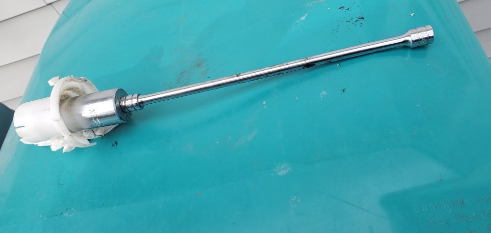

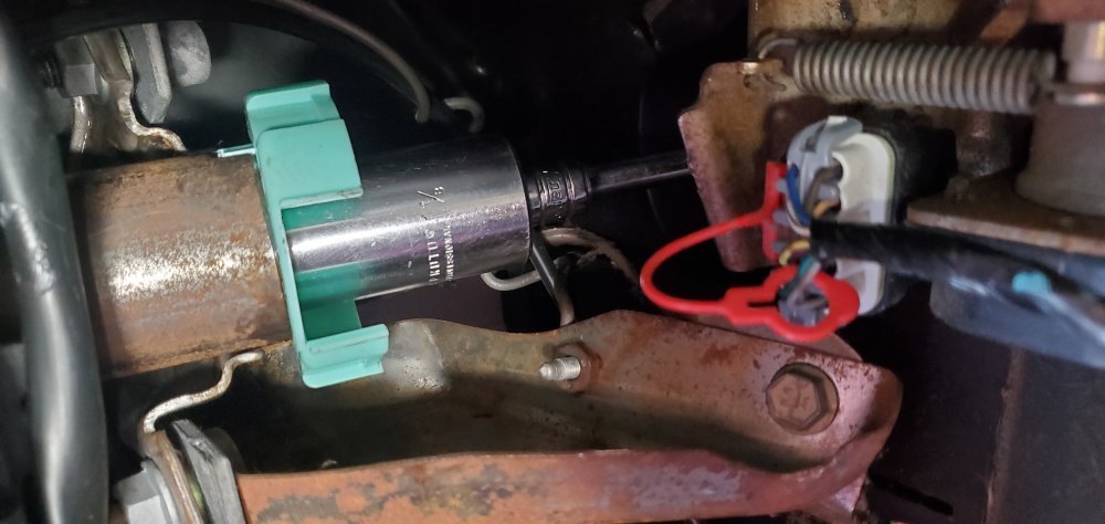

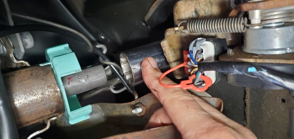

A slick way to install the steering column bushing when the intermediate shaft is removed and old bush removed, is to insert the new bushing as far as it will go (mine stopped solid with an inch left) use a 1 1/8 deep socket and about a 12" extension -pass through the firewall boot and in the engine compartment simply drive the bush home.
Struggled with trying to insert bush by hand, used all the YouTube tricks I could find with no success.
The socket method was under 5 minutes.
