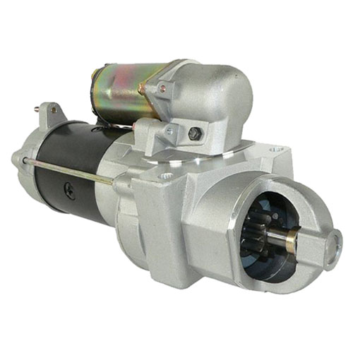

Here are the differences per this site:
Auto:
http://www.fleetalternatorstarter.com/starter_50306.aspx

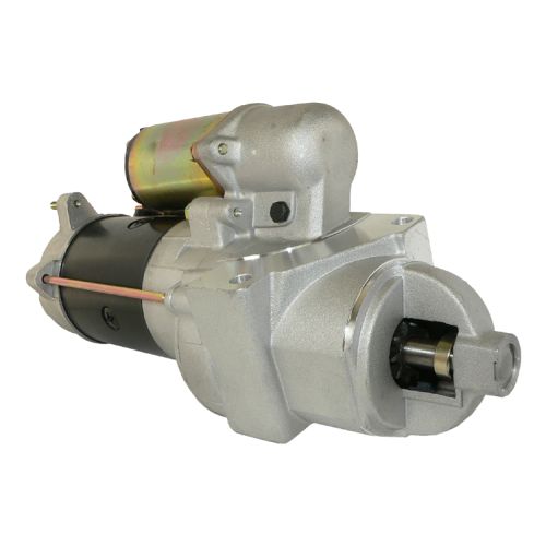

Manual:
They claim this can be substituted and used on auto trans as well.
http://www.fleetalternatorstarter.com/starter_50215.aspx
This is what I saw, also, and was the reason I was wondering. It's been over a decade since I had the starter off my automatic truck and can't recall what the one looks like on the manual truck.
