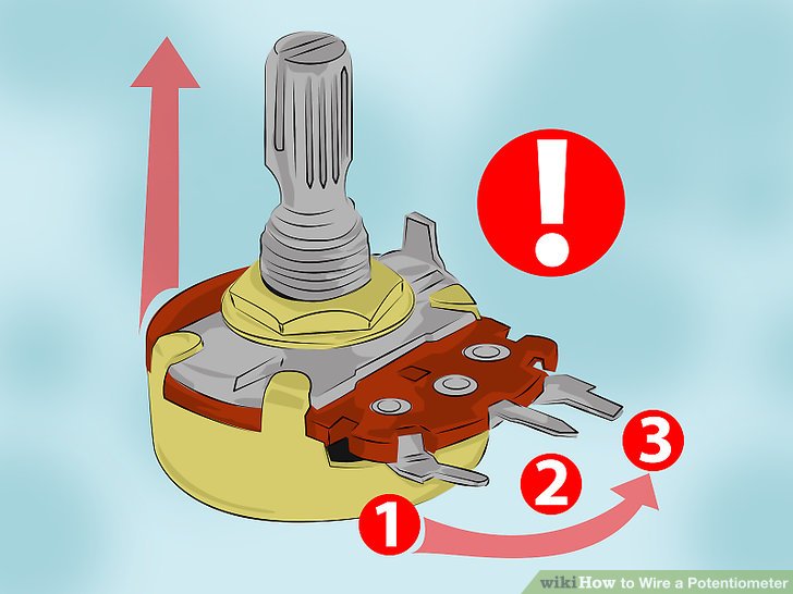

p.jpg Here is a pic. of a trim pot.
The ground goes to the terminal to the left, position 1, when the pot is standing with the knob to the top and the terminals are looking at You.
The signal input goes to the center terminal, No. 2, that would be the wire coming in from the boost sensor.
The wire going out to the ECM will go onto position 3, to the far right.
