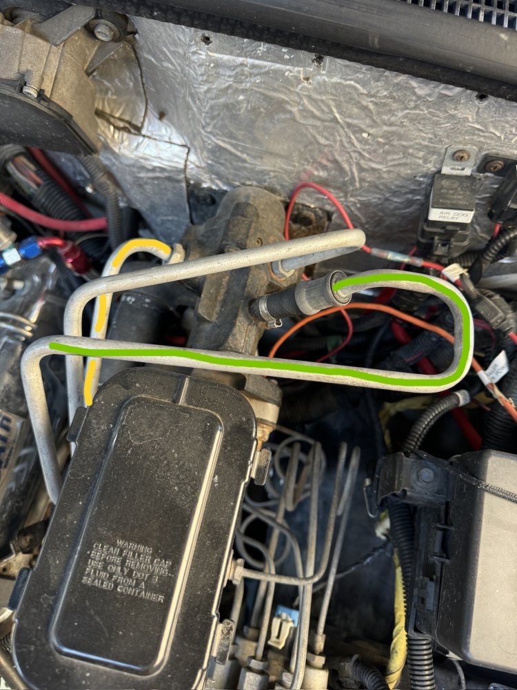

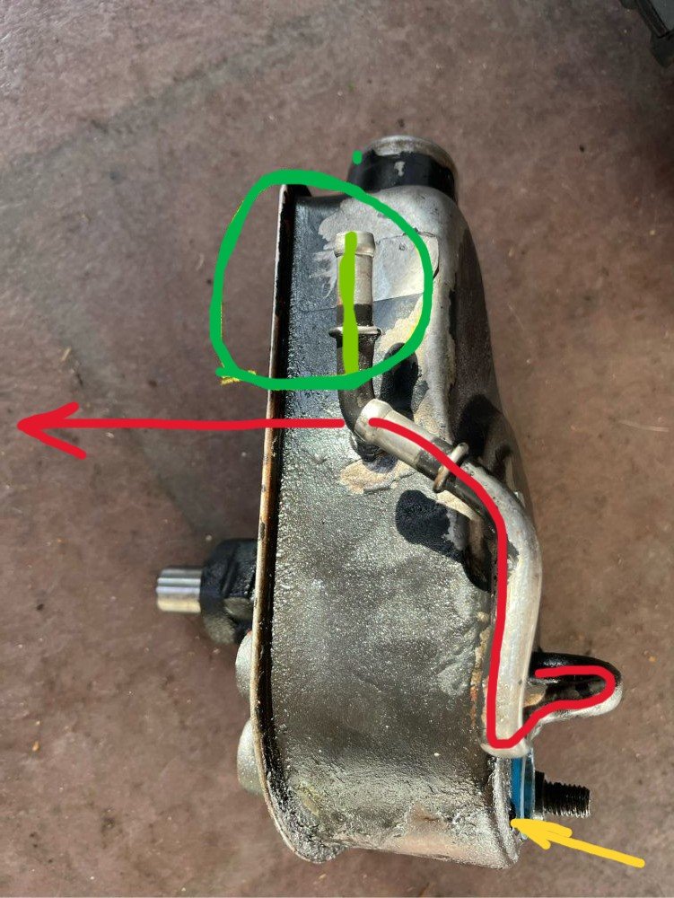

Got the Power Steering Pump installed, but it is not working. I think that maybe I got the hydro boost outlet hose and inlet hose swapped at the pump. I have it on the circled pipe:
IMG_6230.jpegThe pipe next to it has the top left hose from the steering box. Fill it with fluid, put on jack stands, attempted to bleed and flush it but nothing comes out the hydro boost. I have the shop manuals, but the pics are pretty crappy as to where the lines attach at the pump.

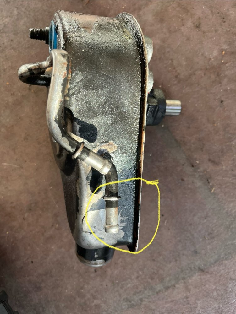

There are only three lines to the pump. One is bent pipe with a fitting that holds it to an arm off the pump. That is the only place it can go. So by process of elimination that leaves the other two hoses with rubber hose going to the two pipes in the picture.
Per Paul, I’ve confirmed hoses are installed correctly. Really the hose lengths dictate which pipe nipple they can go on.
So after experiencing the pump not working (wheels are hard to turn while the front is up on jack stands, almost impossible to turn while on the ground), I attempted to to flush the pump, but nothing comes out of the return outlet at the hydro boost.
The pump will have to come out. I will check to see if I got the o-ring installed correctly on the temp sender located on the back of the pump. Any other suggestions appreciated.

fluid will only come out of the booster return line when you press the pedal and release in spirts. it won't constantly flow like it does with the steering box. if the pump isn't pushing fluid, its ether the variable valve you transferred from the old pump, the pressure relief in the pump behind that large nut on the back of the pump, or this pump sat on the shelf dry too long and the steel vains rusted in the rotor. be ware on new and reman pumps from all of the auto parts stores. don't return your old pump yet. check the orifice size in the center of that large nut on your old pump and the new one. 99% of the time the new pump will have a smaller aka normal size orifice where your original pump has a larger one for increased flow made for systems with a booster. most have to swap this piece to the new pump along with the piston and spring behind it.
