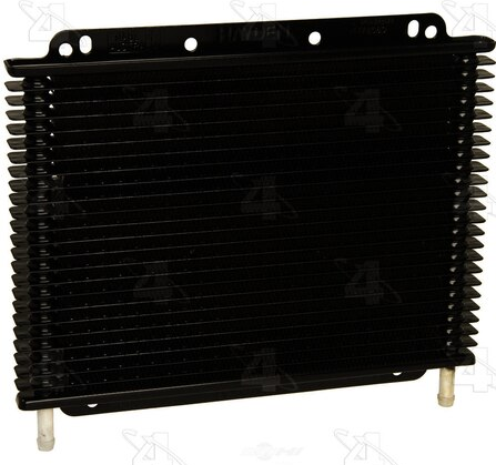

The factory cooler behind the grille off the the side near the drivers headlight, but it's only a small U-shaped loop with fins. I decided to go out on a limb and order a trans cooler to add to the system and just zip-tie to the brush guard just to see if it helped anything at all.

My plan now is to try adding a small trans cooler in the steering return loop and just affixing it out front behind the brush guard in front of the grille, maybe add a couple of 4" PC fans to it (I have tons of those laying around) and see if that helps keep the oil temps at or under 150 degrees in this hellish summer heat!
