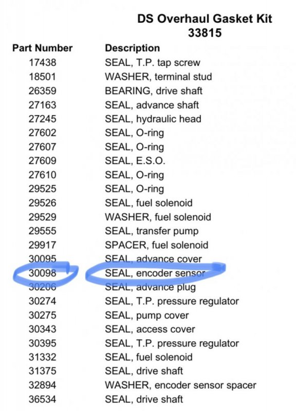

D dieselolds Well-Known Member Messages 461 Reaction score 1,140 Location Canada Jan 5, 2022 #1 Hey guys.Just posting this in case someone here needs the part number for the optical sensor o-ring that commonly leaks.It’s stanadyne 30098. Attachments C5090F45-E674-4BFC-A84A-A77D21E5AD5A.jpeg 89.5 KB · Views: 5

dbrannon79 I'm getting there! Messages 7,522 Reaction score 16,578 Location Seguin, TX Jan 8, 2022 #2 is this the round oring on the sensor or the squarish one that goes on the top cover of the IP? I have heard that top cover oring is hard to come by.

D dieselolds Well-Known Member Messages 461 Reaction score 1,140 Location Canada Jan 9, 2022 #3 As far as I know the 30098 is the o-ring that commonly leaks under the snap ring area upon the optic sensor.I don’t know if that one is square cut or just a odd size o-ring.
