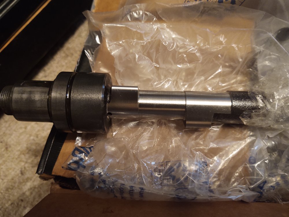

Just got my Massey Harris 44 cam back from Blackburn's Performance Shop. Fresh new grind will add .072"int and .076"ex lift (.550" & .560" at the valves) Haven't got the cam card yet, but should be 15-20deg more duration than my current grind.
