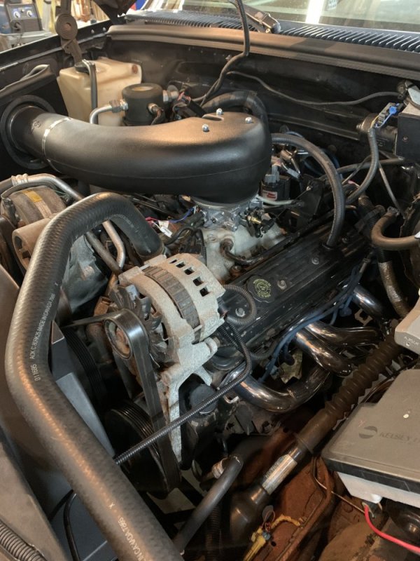

Hi all, - Rob ( I'm a noob ) here from CT. Recently got my father's truck for my son - its a 95 chevy k1500 5.7l. Did some upgrades on it - had an exhaust leak so installed new headmen headers, a Holley aftermarket TBI, K&N cold air filter, performance ignition, dual exhaust ( ditched the catalytic converter - since the truck is older and no longer requires emissions. ( pic attached below ) along with a perf chip from Jett..
I do have a few questions - - I did have to advance the timing a bit - due to truck seemingly having a low throttle response. I also have a leak in the intake manifold and wanted to something performant. Any suggestions? can I ditch the EGR ? ( was considering the Edelbrock or a Holley ) - Edelbrock said something about a spacer? ( if the blades and ports don't match ) = anyone has experience with that? Lastly - any suggestion on what plugs to run? ( a bit warmer or colder? - since the exhaust seems richer ) - otherwise, the truck is super clean w/only 75k miles on it. Sat in the garage most of its life.
Oh, lastly - I assume this is not a Vortec motor? since I noticed that it has 12 bolts on the manifold 6 on each side.

Get a refund on the K&N air filter. (And is that a "Hot Underhood Air" intake kit as well? :yuck: ) You will get better results just running a gravel screen. At least a screen won't clog up while letting the same ring dusting and Idle Air Control fouling dirt by. The K&N will foul the Idle Air control to where the Idle RPM drops so low the engine starts and immediately stalls. Bluntly you are better off with the OEM intake and a "functional" paper air filter. K&N has let me down a couple times and one of those times was on a boat replacing a Flame Arrestor! (Aka Gravel screen.)
The EGR is used for knock control. Under certain conditions like extended high throttle, load, and higher outside dry air temps, the reduced backpressure from the exhaust changes you made can leave you with pinging you can hear on 87 octane - with a stock tune. I don't know if the Jet Chip requires 90+ Octane gas?

The K3500 I have, when I bought it, it had a K&N filter in the stock filter housing. I took one look at that thing and tossed it into the trash. If Your engine is running rich, it could be the O2 sensor{s} is getting bad or, that K&N has it choked down so tight that the ECM can not allow for that much restriction.
