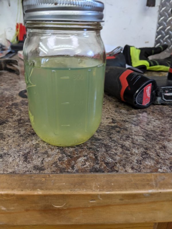

Went and got some fresh fuel to see a comparison the jar on the left is fresh and the jar on the right is out of my tank it is definitely cloudy but still pours fine I wouldn't think it would be jelling up before the lift pump and making it not pump
