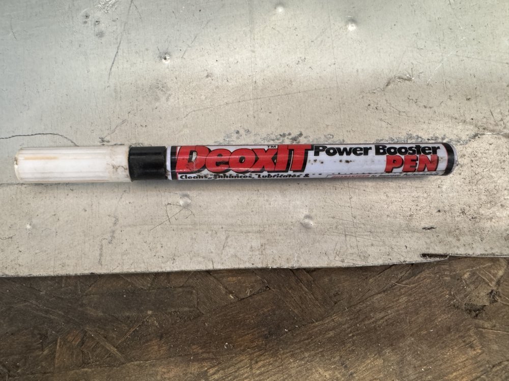

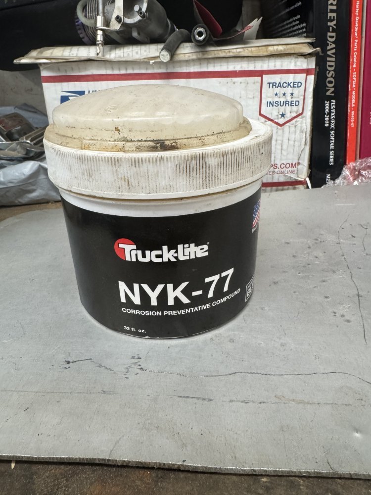

Using whatever tools is necessary to scrape, scrub or wire brush each and every terminal in each connector so that they are clean and shiny. Then use a nice corrosion preventive on each terminal, do not use any form of dielectric silicone compound. That stuff promotes insulation values.
Instead I use this Truck-Lite compound very sparingly.
Or better, if a parts house or hardware store has some of this.
Then see how it performs.
