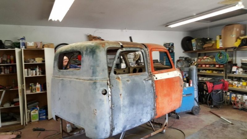

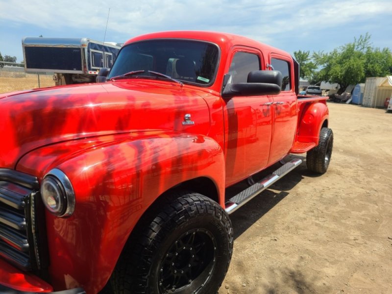

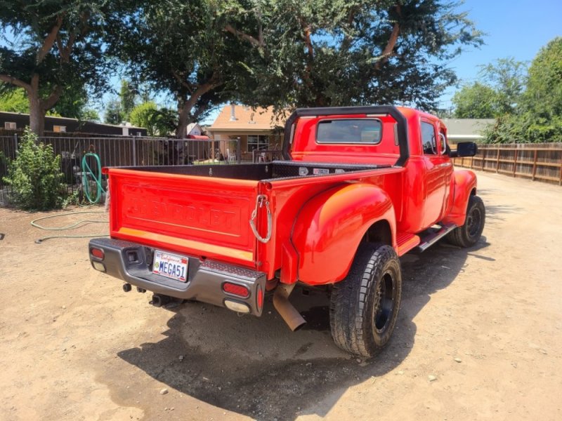

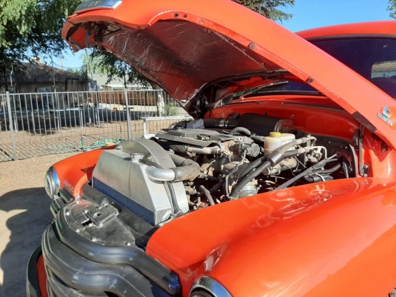

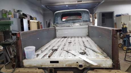

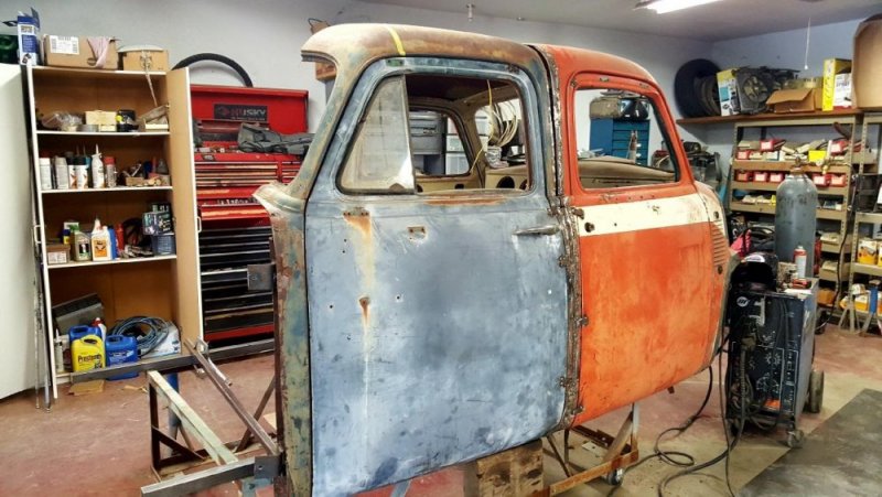

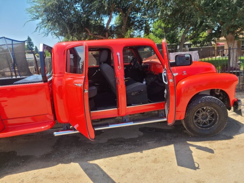

I built this truck from a 1951,53,54 Chevy and a 2011 Dodge Ram 6.7 Cummings diesel 3/4 ton 4x4 it has all the amenities including the ice chest in the rear floorboards like the newer trucks ,I welded two trucks together back to back so I could have suicide doors. I used a 54 chevy long bed . I welded the bed floor out of the 2011 bed and used the factory gooseneck so I could pull my 31' 5th Wheel trailer . It's also has the Jake Brake.3026.jpeg3027.jpeg3023.jpeg3029.jpeg
