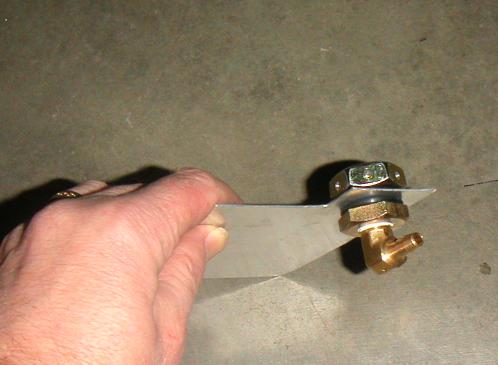

I will also nip the air tube on the sender plate so the last 1\8 top of the tank doesn't take forever to top off. I despise waiting for that design. I don't need the tank to slow down when fueling, I can do that myself and deal with the foaming as need.
