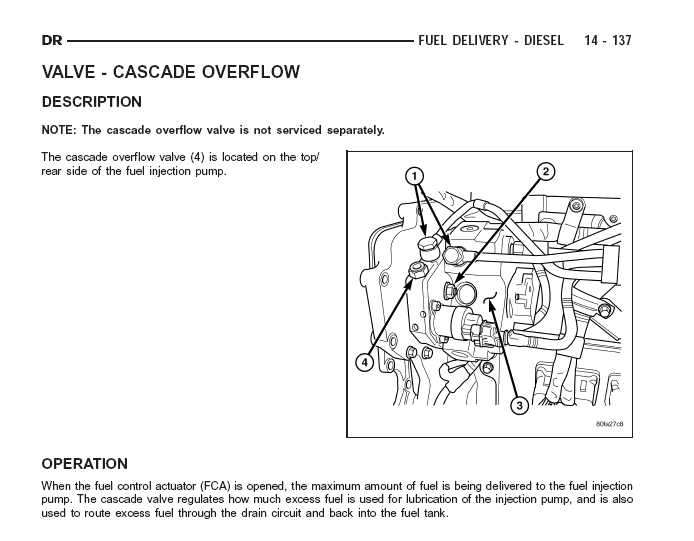

Or, he has a casade overflow valve (on the CP3) or pressure relief (on the fuel rail) valve that needs to be replaced.
It is designed to open up at different pressure and re-route excess fuel from the rail back to the tank.

If he had the cascade overflow valve replaced, I'm betting that the mechanic didn't get the lines tightened down enough.
The fuel delivery system on the CR's is HYPER-sensitive to proper torqe specs on the connections.
I had an issue when I replacd my injectors. I didn't get the connector tube nuts to 37 ft/lbs and I was losing rail pressure and the fuel was diverting to the return line. This sets the same code as the cascade overflow vavle will. It will show as a Fuel Delivery Error, code P0148

Unlike what the service manual says, the COV can be serviced seperately.
It's a $45 pice.
