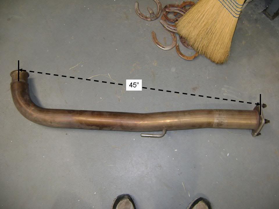

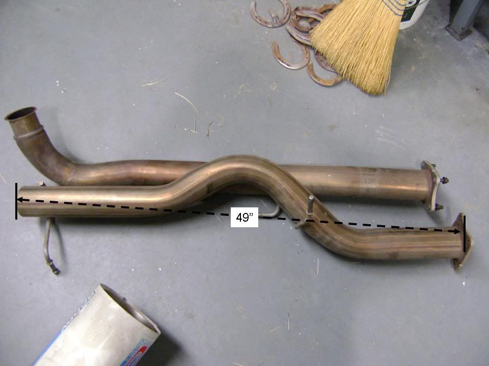

I have the whole exhaust off on an '04 Duramax on the shelf.
That didn't have the cat on it, so you could use that front pipe.
If ya want I can grab a few pictures if you want to give that a shot.
