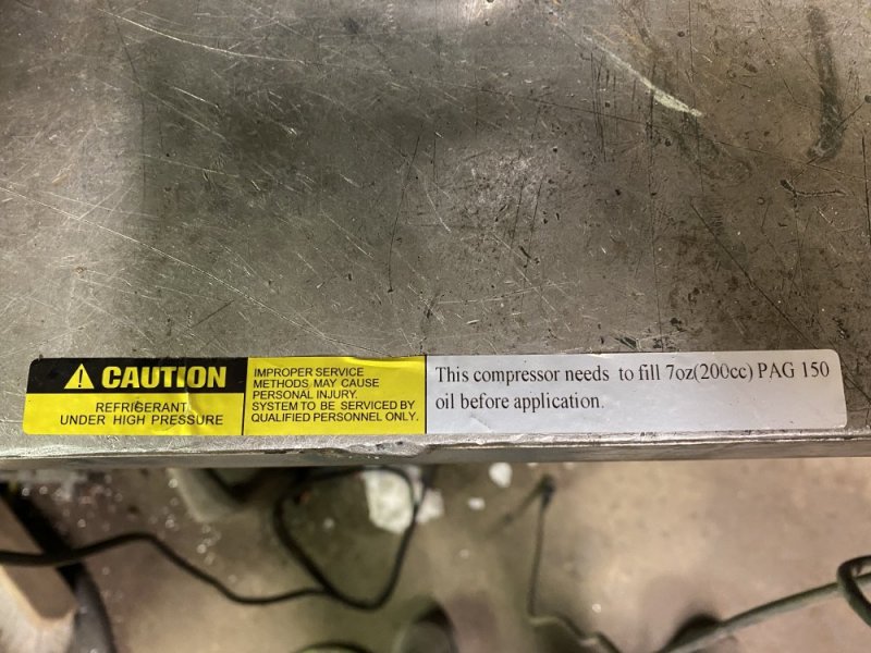

The second time, the compressor had a sticker specifically saying to put 7oz in the compressor, so I did that and out 1oz in the accumulator, also PAG 150.

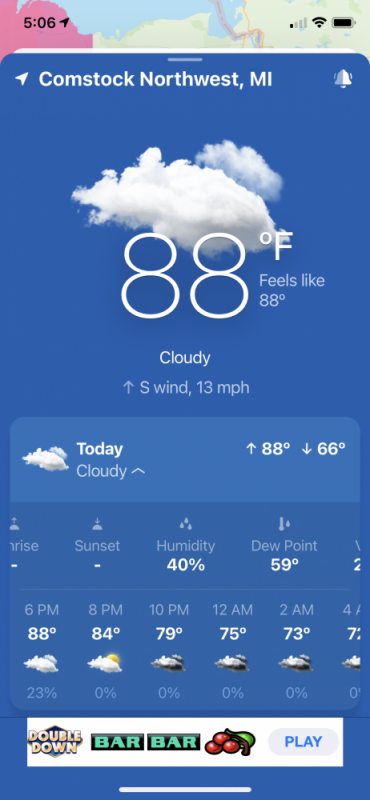

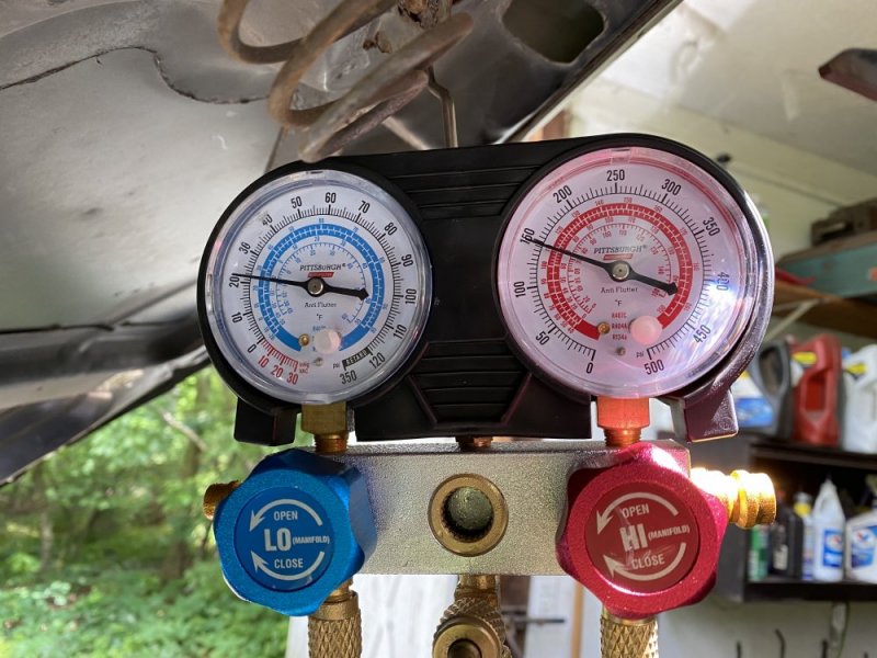

Here are the gauges with it running today. This is with only 5.6oz of R134. It’s 88 degrees out and 40% humidity.

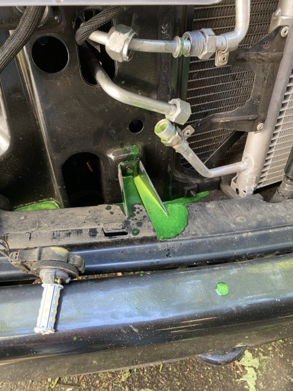

That looks like A Lot of dye!
I’m adding it to the low side. I’ve been using the oil with the dye already added.

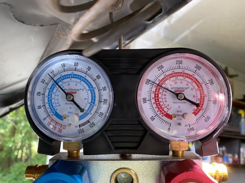

I just tried it again and same results. The refrigerant line was HOT pre-orifice tube and you could hear the refrigerant hissing loudly there. It sure seems like an orifice tube problem. I have a couple more new non-VOV ones I can try. I was also thinking about running it without an orifice tube, mostly to see if it pointed to a restriction in the evap instead. Is that a dumb idea?

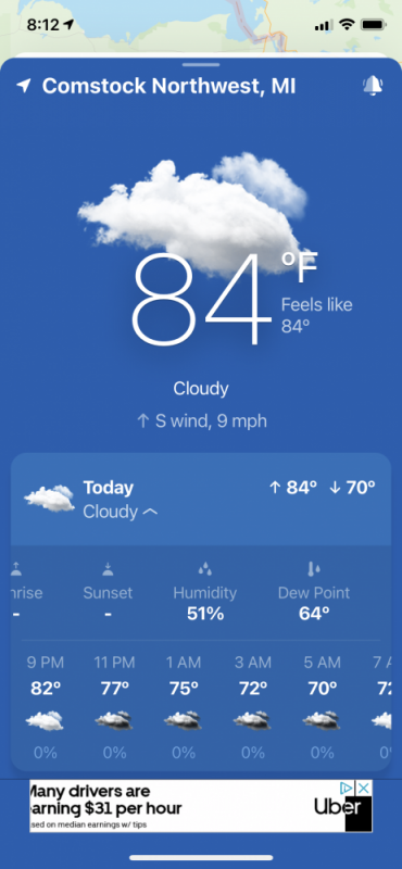

84 degrees and 51% humidity.
How hot is the condenser? If it's around 170 degrees it's simply overheating without enough airflow. What are the temps? Are the evaporator pipes about the same temp with a full charge? I assume you have a fan on the engine of some sort that's running?

The evap was ok to touch, but the pipe up to the orifice was too hot to touch for more than a second. The batteries were dead in my IR gun so I couldn’t get a temp. I have the electro-viscous clutch that AK Diesel Driver figured out and I have that commanded on so it’s drawing some air across the condenser. I haven’t been able to get a full charge in it because the first time I started charging the system it smoked the compressor before I had half a charge and the second time it was on its way to smoking it so I’m not trying to put any more refrigerant in until I see some more normal values. Oh, and the second time I went through this, it was only like 71 out, so it was barely warm enough to use and it was still carrying crazy high pressures.
