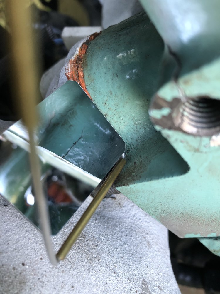

So long story short I'm working on my multiyear K3500 1 ton Dump truck build. Sometime this spring a mud wasp had plugged up one of the holes in the front passenger cylinder head where the longest A/C compressor bolt goes through both mounting brackets and into the head. So I picked at the plugged hole with a piece of wire I had lying right there, sprayed a little WD40 into the hole to get the mud and dead insects inside to clump up, and pulled the majority of it out thinking I was done. Put a dab of antiseize on the threads, got it started by hand then put my little 12v ratchet to the bolt. A few turns, sounds like it's getting tight then POP! and it's loose. F@%!
I've heard about wet holes causing cast iron to crack like this, but never encountered or experienced it myself until now. I had no idea the little bit of WD40 and antiseize would form a liquid that with 30ft lbs of torque from my puny cordless ratchet would crack a casting but this is just how my luck goes.

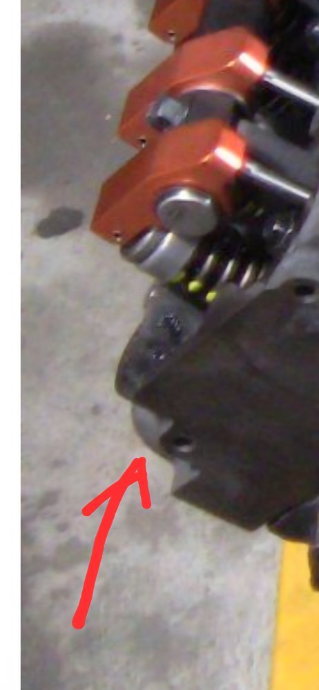

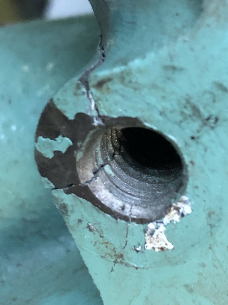

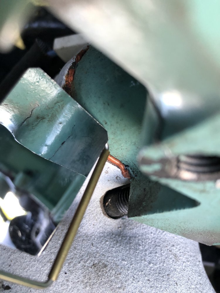

Both main cracks along the side do not meet. I tried to wiggle the piece out, not too hard but it seems pretty secure still. I can thread in the bolt and it has good bite. Here's a picture with a mirror showing both main cracks along the passenger side of the head moving towards the exhaust port
The lowermost crack doesn't appear to travel as far back as the upper one.
My main concern with the cracks, seeing as how they don't appear to travel all the way back to the end of the threads, is having them spread further and worst case scenario having the crack spread into a water jacket and causing big problems from there.
So before I cut into an old head to see what I'm dealing with behind these cracks (provided it's relatively similar geometry seeing as how this is a P400 head) does anyone know what lies behind/ between this threaded boss and the #2 exhaust port?
I am fairly certain that the only way to stop the cracks from spreading/ growing is to drill into the metal where the crack terminates. But I don't want to drill blind especially if there is a water jacket close by. Plus I'd have to remove the entire exhaust manifold and turbo and inner fender to get to the lower crack. Which I'm more than willing to do if it is the right course of action. But before I do the reverse parts cannon and start stripping the thing down, I'd love some advice from the experts as it's once again amateur hour here.
If given that I have good bite on the bolt still and there are several other bolts supporting the A/C compressor and bracket, what would the best course of action be to secure the bolt and prevent further cracking? Threadlocker? Make a brace that attaches to the bracket and is secured elsewhere on the engine and don't put a bolt in the threads at all?

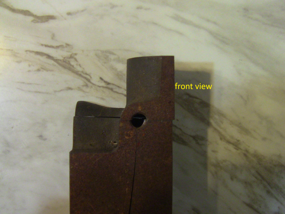

This is how I cut the broken bolt hole.
Another view from the front.

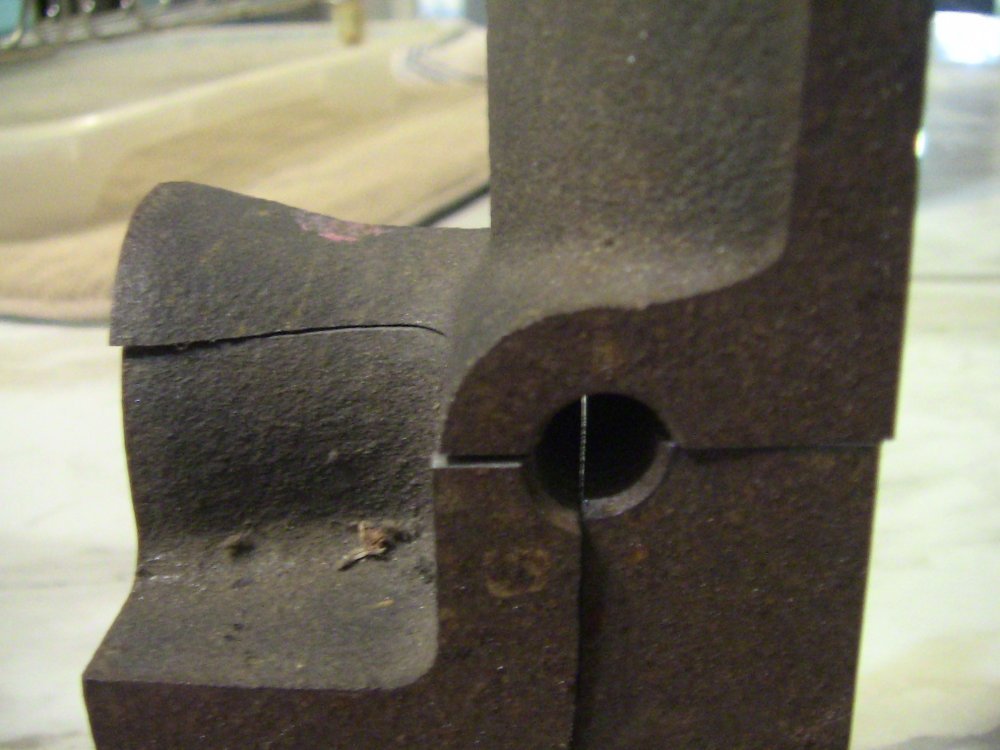

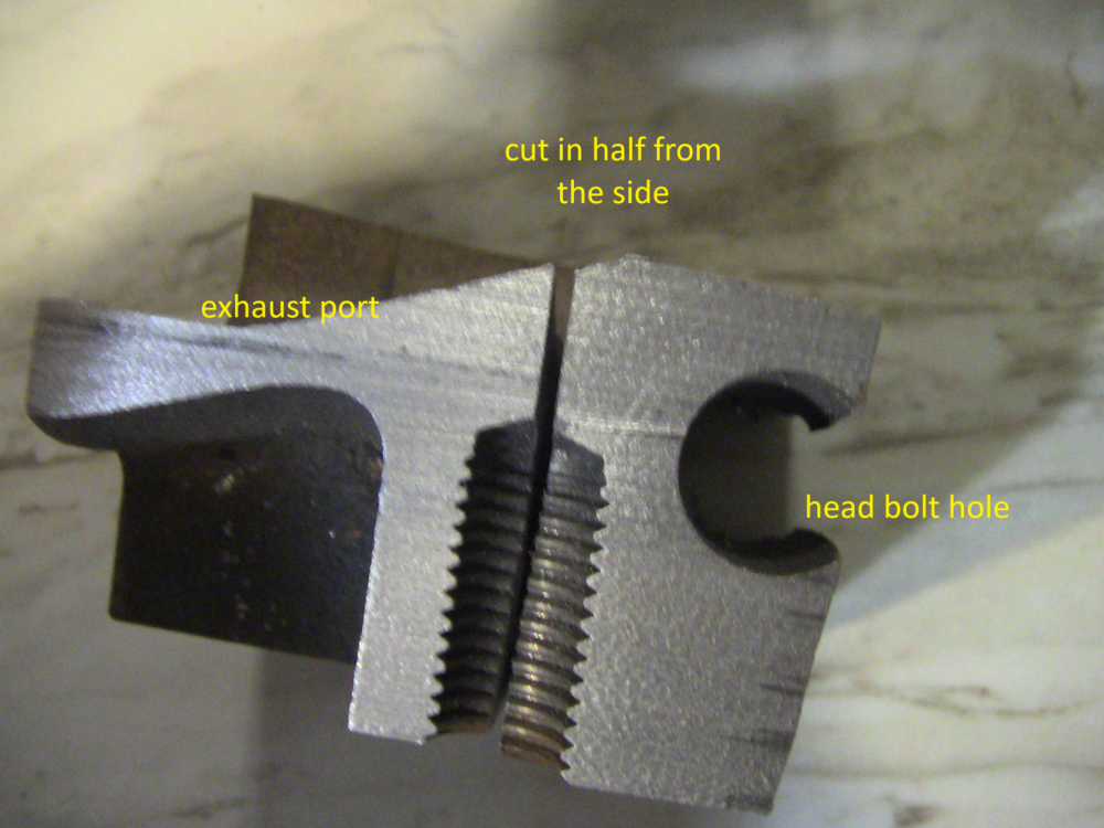

Looking from the TOP, the bolt hole cut down the middle, you are looking at the lower portion .

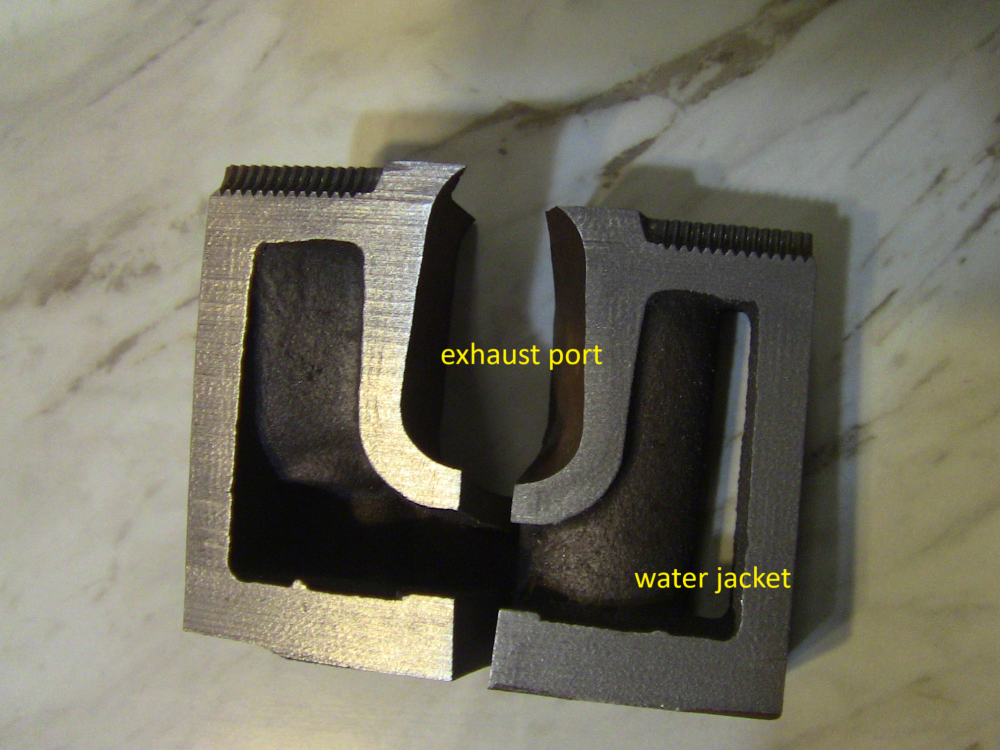

Then I cut this in half, there is a water jacket, the jacket is in the inside part of the bolt hole...
My advice would be to clean inside and outside very well, if possible, grind a grove on the outside crack, install the bracket and SNUG that bolt, apply the best epoxy you can find for GRAY IRON, let cure, hope for the best.
Looking at your pics and my cutaways, I think you will be ok, if that ear does pop off it's on the outer side, so no water should leak. As you can see it is close to the head bolt hole, the exhaust port, and water jacket so take care and good luck...

Thank you so much for the help and detailed cutaways @Twisted Steel Performance
So no drilling necessary to stop the cracks, just grind and fill and pray?
Just had another idea, the bolt that goes into this hole goes through a sleeve on the bracket that is bolted to the head. I could get a shorter m10x1.5 bolt and try to get some sort of threaded insert to put in the sleeve. That way the bracket is secure and no stress is put on the head.
