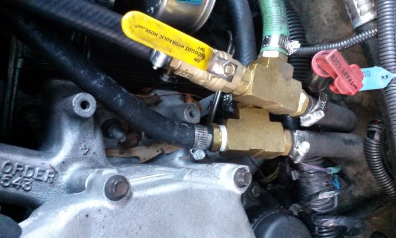

Find a brass tee, should outlast the truck. I bought it at discounthydraulichose dot ...
I replaced mine with a 3/4" tee on all instead of the stock 2 of 3/4" and 1 of 5/8".
I have also replaced the coolant x-over with a 1/2 NPT to 3/4 barb so all the hoses are 3/4" from all direction.

I decided to keep the OE mix-match hose sizes and built a T from discounthydraulichose dot; also added a manual cut-off. Only down-side to the manual cut-off is that I have to remember to open it up when the whether starts to get cool :D

As you know steaming is less an issue w/waterless coolant however IMHO the loop is necessary in our applications to vent any steam.
I have the shut of valve to heater core also. I love it. Helps a/c perform better.

When I did the re-power, the nylon T's came out and the brass fittings went in as I did not care for another cracked junction in the middle of a 1,000 mile road trip (again).
