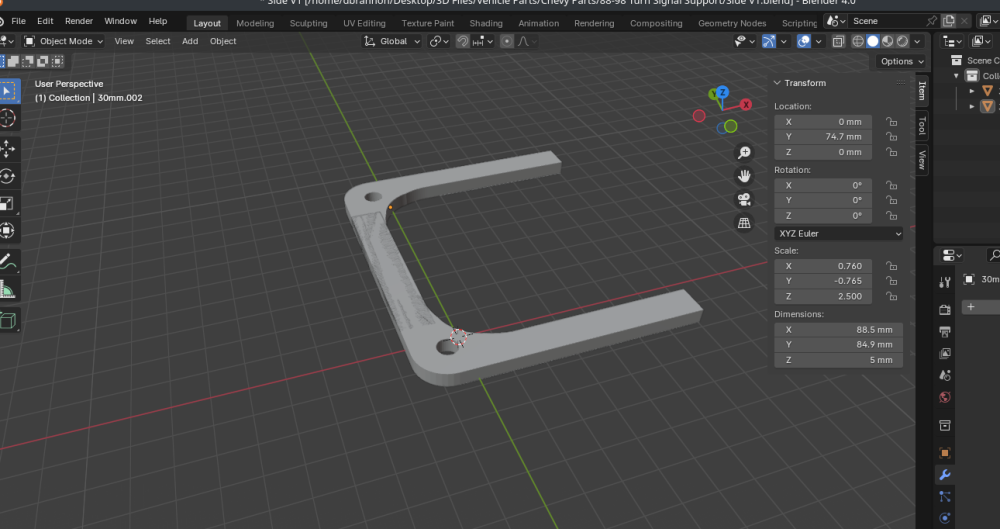

Here is what I have so far. It's just half of one side, but eventually I will have the rest setup as a single piece.
the plan is to have this as a single piece surround the housing, it will be recessed to fit and if needed, a second part to serve as a backing plate sammiching it all together.

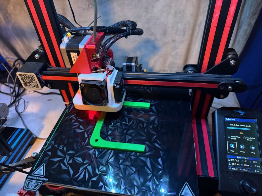

It's been a chore to get the corners and angles right, print a piece, then measure, fit and go at it again. Here is the part shown above being printed using some basic filament for test fitment.

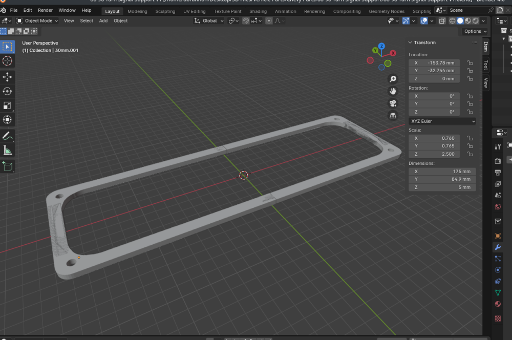

Here is the complete support on my PC in a rough draft form. Unfortunately it's too long for my printers to handle as a single piece! I have to split it in two with some interlocking sections to print. I am able to orient it sideways on my big printer to get it in one piece but would take 6 hours to print. not ideal for just a draft piece. maybe once I get the final design finished I can do that!
