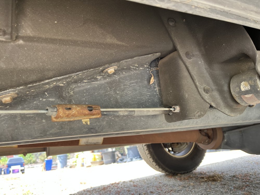

When I pulled the axle at the pick a part yard, I had to cut the parking brake cables. Here’s what the install looks like on a living GMT-800:

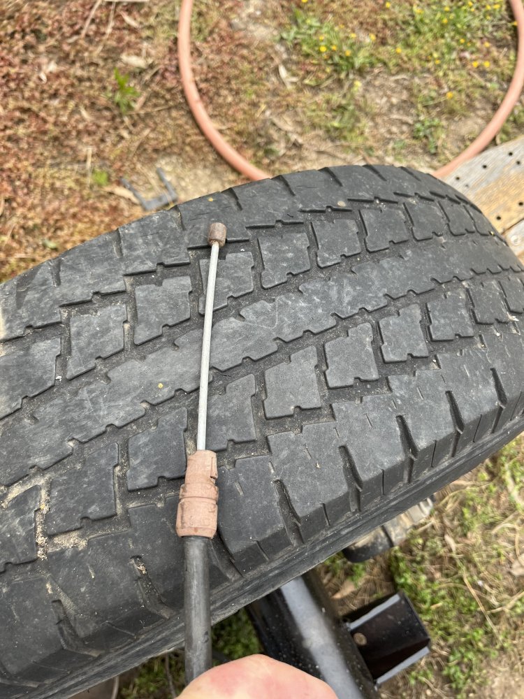

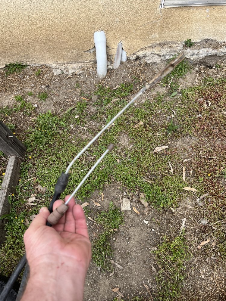

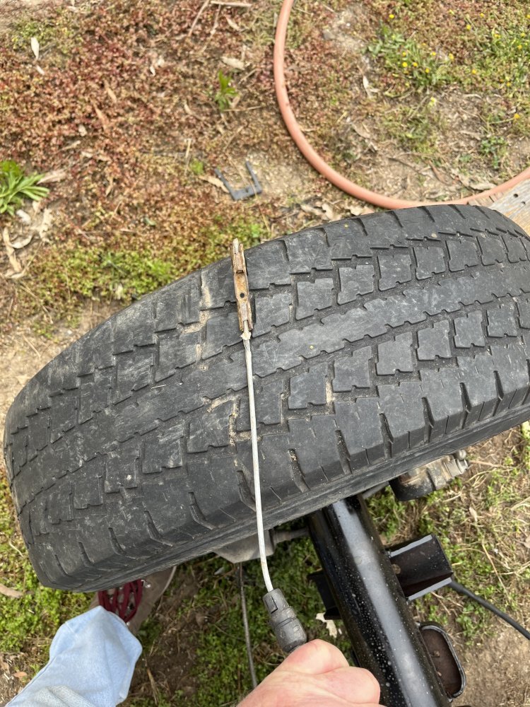

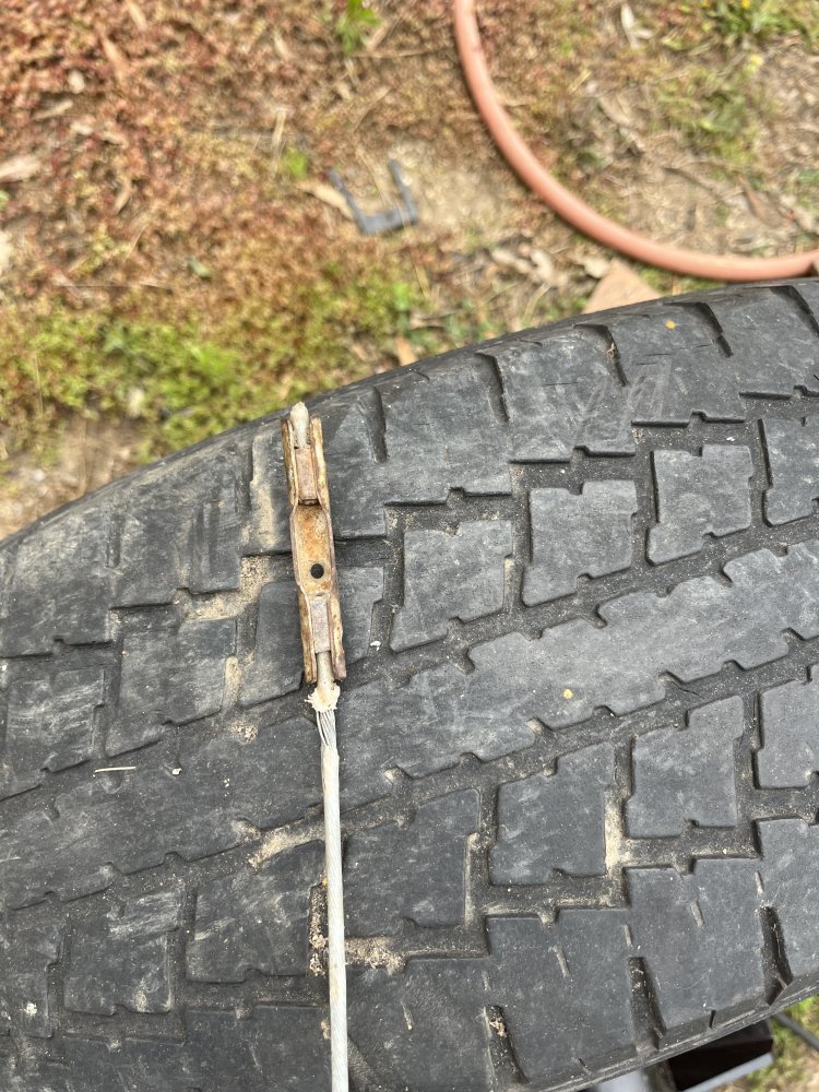

And here are my cables to show where I cut them:
Memory is bad here. I’m trying to figure out how I would connect them to the existing Suburban cables and where I would get the connecting part to do that.
The GMT-800 fitting I showed is like a Y joining the shorter with the longer cable, with the longer cable then joining the PB cable.
I think that was how the cables on My 1993 was set up. I dont remember the exact configuration but the main cable from the front connected to, IIRC, the left rear and the RR Yd off of that.
