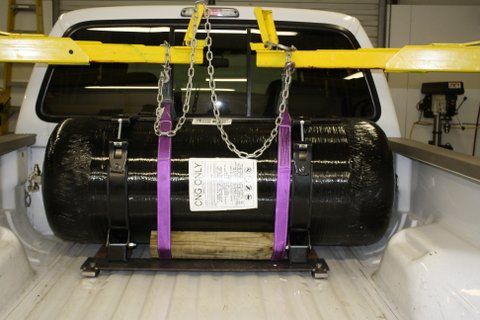

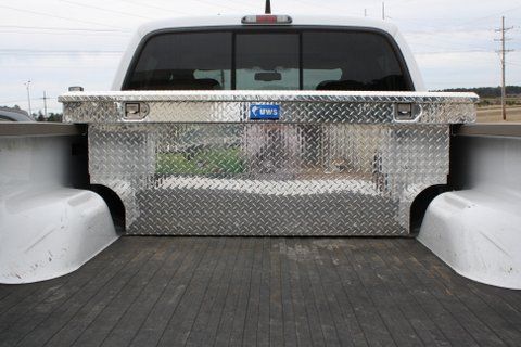

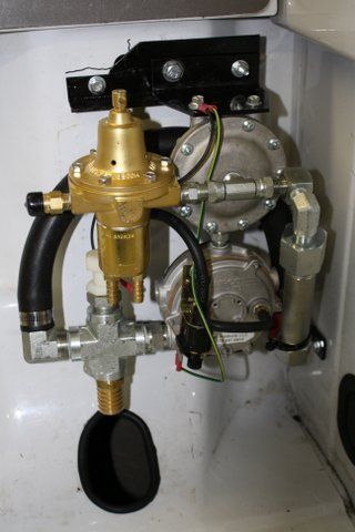

here are a few piks of the deluca fuel products cng install. a class 4 lincoln composits tank, the cover & regulator assys. the regulator opens by reading the press diff between the turbo & air cleaner. the dash mounted milage -o- meter says it is doing 26+ mpg around town & 35+ & gaining on the road. this land whale will burn the tires now! i have a programable pyrometer in the cab that turns the cng on / off at preset values. right now i have it set at 900 in / 1200 out.
