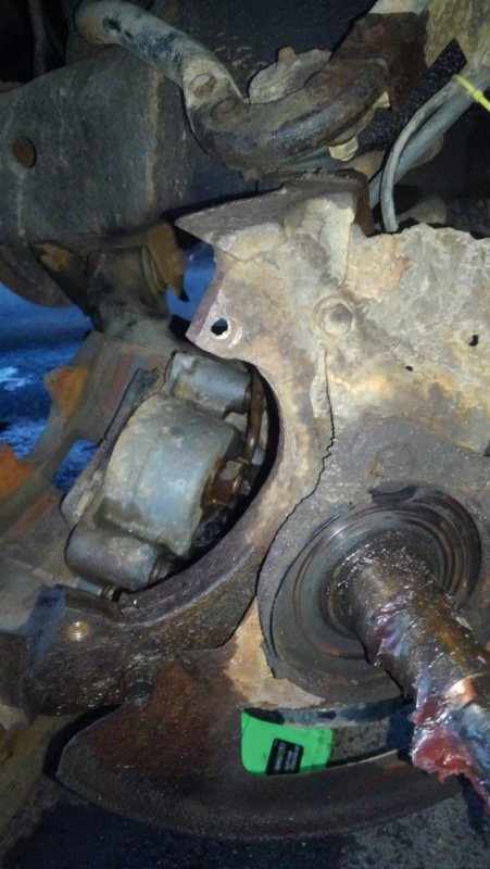

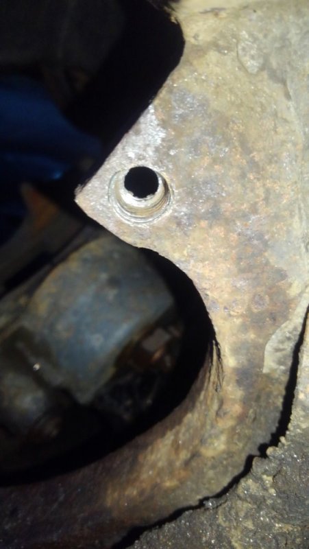

Went to change the pads on the truck. Wouldn't you know it ,bottom slider bolt broke trying to get it out. So I drilled it and tried using an easy out. No dice. Will not come out.. but easy out rips the hole open e bigger. So I tried using a tap, thinking I could get it to pull the remnants of the bolt out of the threads.. nope that didn't work.

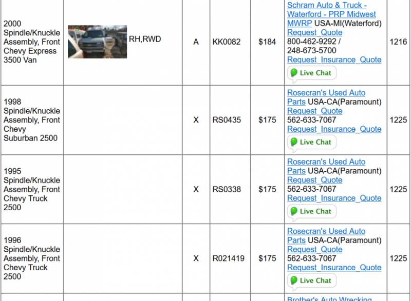

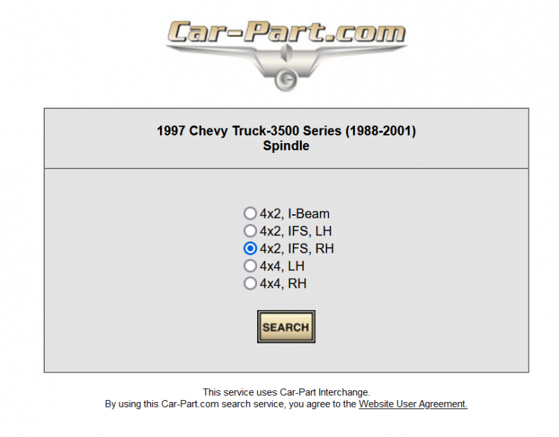

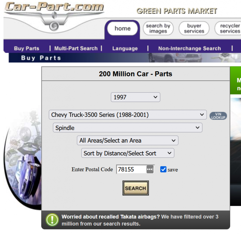

So, looks like my last option is too healy coil it,.. before anybody says so. Yep I know it's a bad idea... But I'm out of options. I called AutoZone ,advance Auto ,RockAuto, our local Pick-A-Part salvage yard.. salvage yard doesn't have any of these trucks that are dually.. and auto parts stores including RockAuto cannot even get a spindle assembly/hub. Such a wonderful day in paradise.
