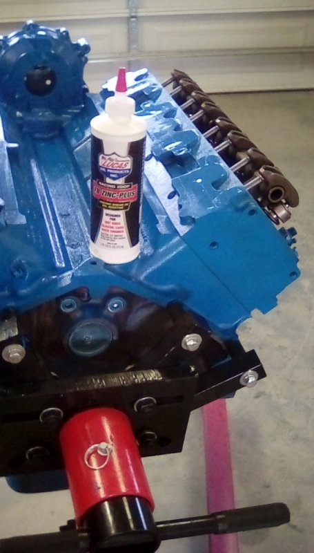

Getting close to first start up of a rebuilt 6.2. What would you recommend for first start and getting the rings and can settled in? Planning on adding Lucas TB Zinc Plus to get things started.

The Lucas is good stuff. The Zinc level may not be EPA road legal per my oil analysts lab comments. IMO it's needed more for the flat tappet Cummins than the roller lifter 6.2/6.5's.
