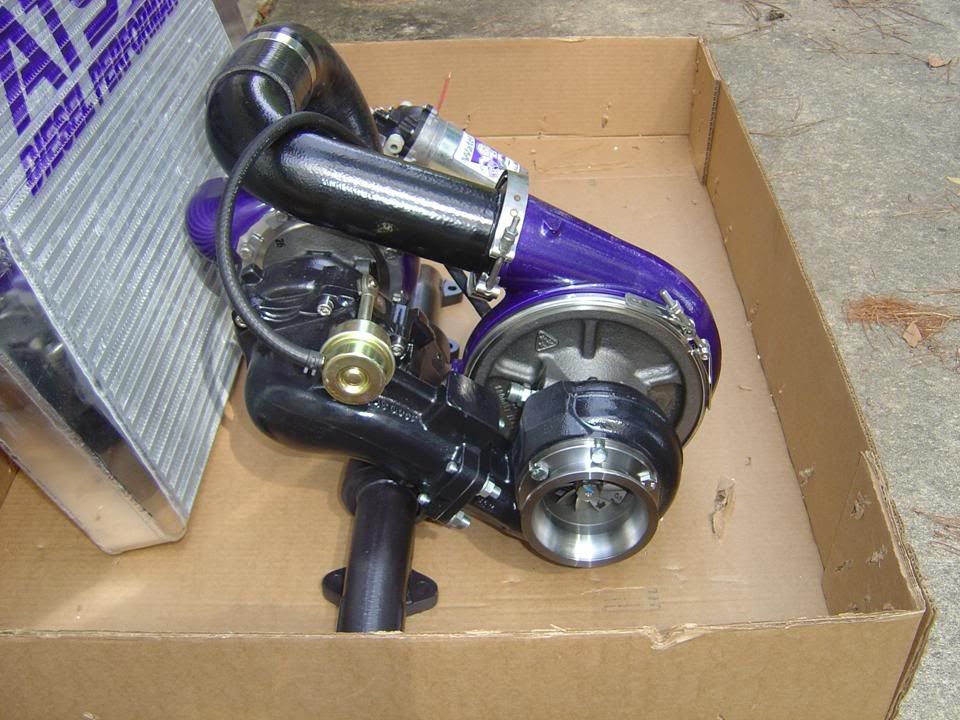

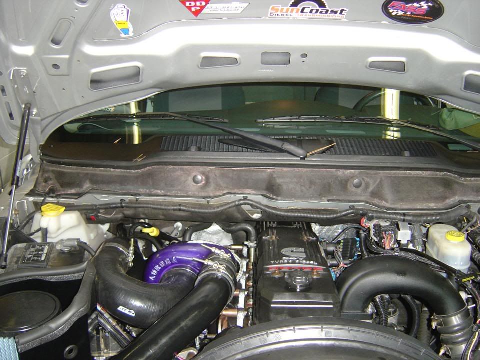

ATS Aurora Compounds on the silver 2500:

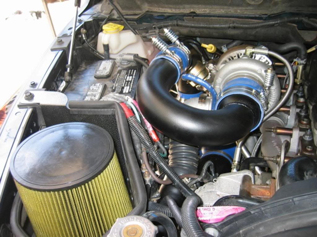

BD Power R700 Compounds on the blue 3500:
Now to begin, neither setup was completely problem free during the installation, but the BD setup posed many, many problems than the ATS setup did.
The problem with the ATS kit were:

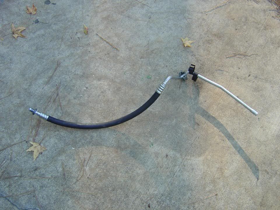

1 – necessity to relocate an AC line, which required getting one made at a local shop. Cost was reimbursed by ATS with receipt and picture of modification.

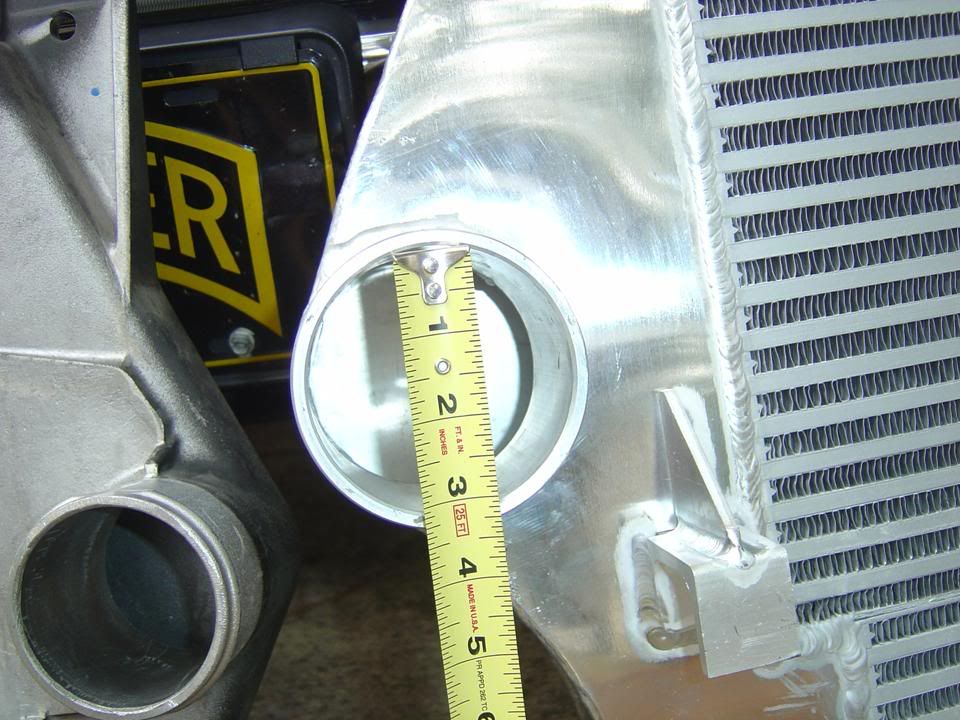

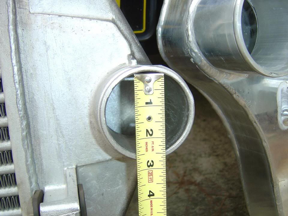

2 – the turbo to intercooler boost boot was sized for an OEM intercooler, which required calling ATS who sent the correct one free of charge and overnight.
Now, the BD kit had these issues:
1 - missing band clamps
2 - incorrect studs for primary turbo to adapter bracket (wrong thread pitch and depth)
3 - missing exhaust manifold cap head bolts
4 - primary turbo adapter bracket would not clear coolant line even when cut as described
5 - primary turbo location causes contact with the passenger side spring mount

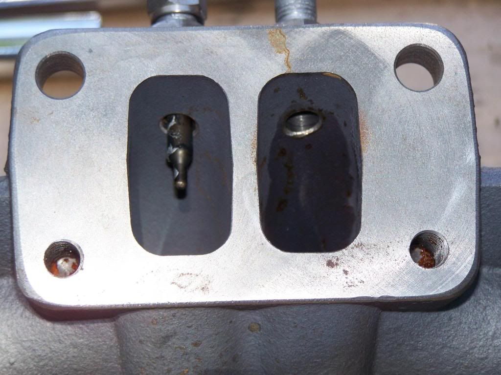

6 - 1/8 NPT EGT holes were incorrectly tapped and were on the wrong side of the manifold for this application
7 - down pipe flange was at the incorrect angle to mate with the primary and clear the firewall
8 - instructions for compressor housing, turbine housing and shaft housing alignment were incorrect
9 - no torque specs on fasteners (instructions simply said to tighten)
10 - air box bracket to radiator was poorly fit
11 - v-band clamp for secondary to elbow did not fit correctly and had to be tweeked
12 - no rust preventative applied to parts (there was rust on many of the cast parts, including the turbine housing, including the insides.
13 - piping needs to be fixed (the intake tube and secondary boost tube make contact with each other)
14 - secondary oil drain adapter had to be modified to fit the frost plug hole (it required beveling the edges with a die grinder to get it to seat)
15 - several nuts had to be filed in order to clear adjacent parts, specifically the secondary to manifold nuts so they clear the oil drain
Now, all of the issues above, for both setups, were able to be resolved locally with either parts that were available in the shop or by running to the local hardware store.

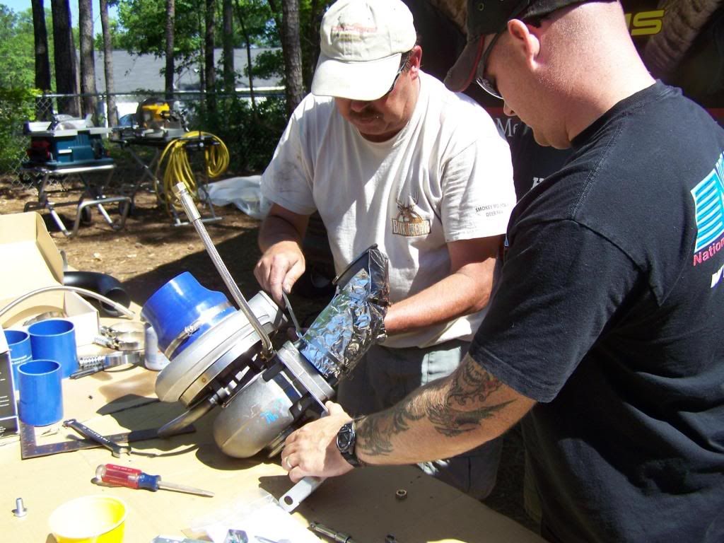

When the parts arrived, they were in very different conditions from each other. The ATS kit came completely assembled and made for a very easy install. You had the finished product to look at prior to installation.
The parts arrived complete, free of rust and corrosion and clocked correctly for the application.
The BD kit arrived in multiple boxes and unassembled. Upon initial inspection, there were numerous parts missing (as noted previously) and there was considerable rust and corrosion on and in the turbine housing.

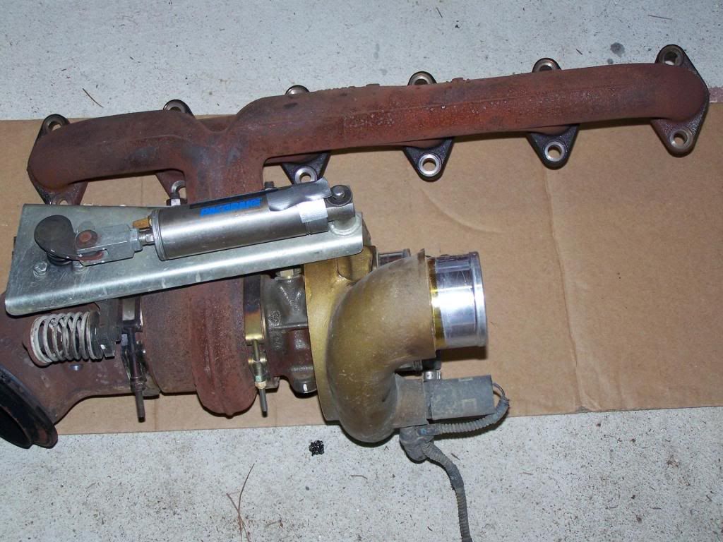

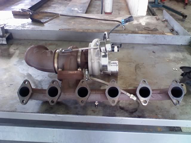

To begin, obviously all the original parts had to be removed. Both of the trucks had OEM manifolds and turbos, both had AFE Stage II intakes, both had 5” exhausts installed. The blue 3500 had a Pac-Brake that had already been disconnected and posed no additional labor to remove.
Silver 2500:
Blue 3500:
Once the old intakes, manifolds, turbo’s and passenger side batteries were removed, we can now start doing a few things were common to both kits, but became uncommon very quickly. Both kits require pulling out a frost plug leading to the oil pan for the drain on the secondary charger.

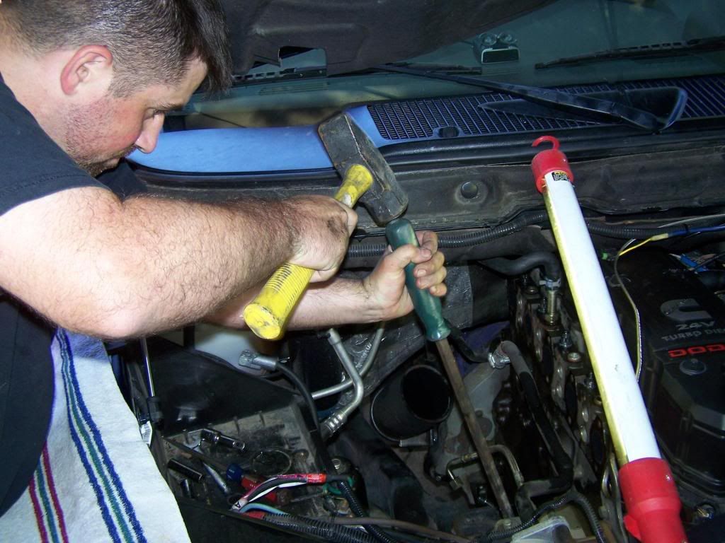

The secondary turbo also required a steel adapter to go in the frost plug hole. This adapter did not fit. The instructions said that you may have to use a punch to get it to fit….this was a mild understatement.
I tried brass and steel punches, using a reasonable amount of force and it would not even seat. I ended up need to use a pry bar and a mallet to mark the adapter where it was oversized so it could be re-sized wit h a die grinder.
Once it was chamfered and resized, the secondary adapter was installed. The picture below is of those two components and their associated hoses and clamps installed.

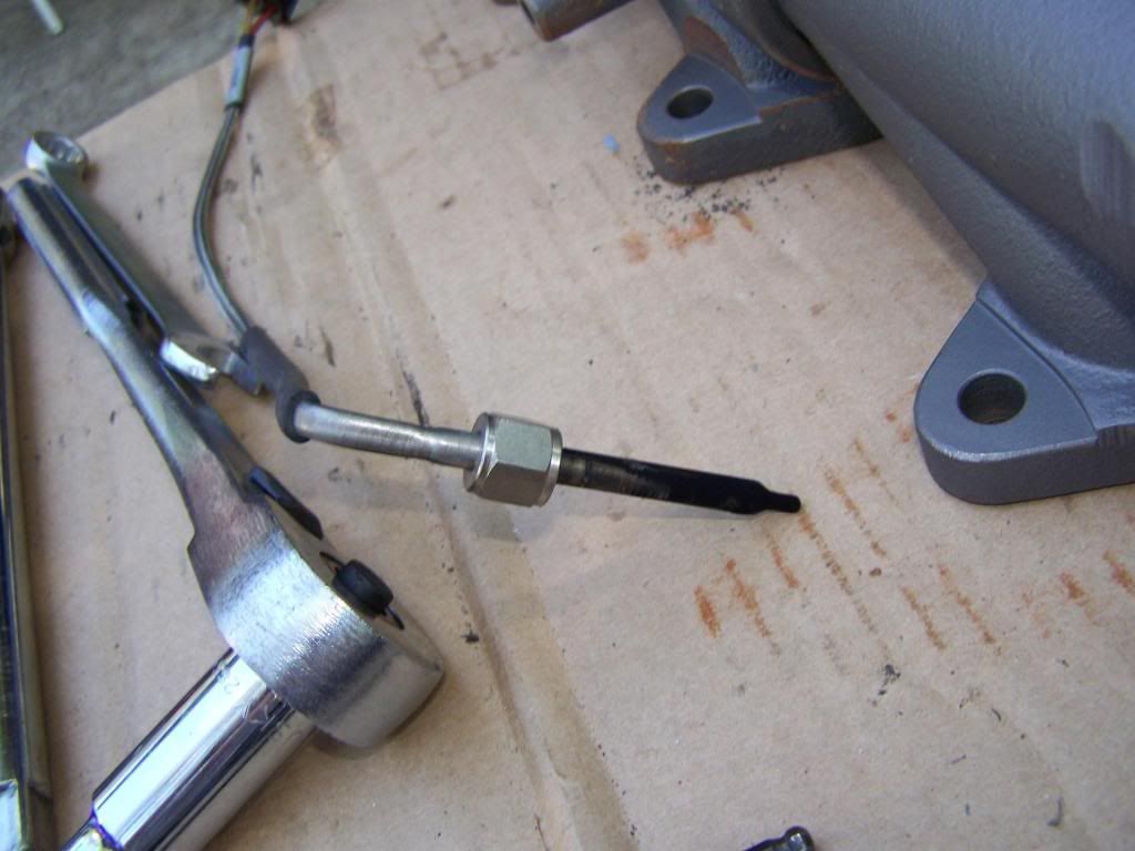

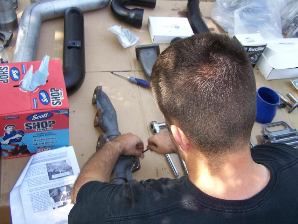

The ATS manifold came pre-drilled and tapped with four 1/8 NPT ports. Two on top and two on the bottom. These ports were in the correct locations for the application and were correctly tapped.
The BD kit came with two pre-drilled and tapped ports. The ports, as the manifold was to be installed, were located on the bottom of the manifold. They were also not tapped deep enough to properly seat a 1/8 NPT fitting. We could only get 2 threads of the probe fitting in before it stopped. This required tapping the manifold further to allow proper EGT probe function.
Once this was done, we installed the EGT probes and found another problem. The location of the ports on the bottom of the BD manifold did not allow enough clearance for straight type EGT probes. The probes ran directly into the side of the SuperB compressor housing. We ended up taking two 90* probes off of another truck to make them fit.

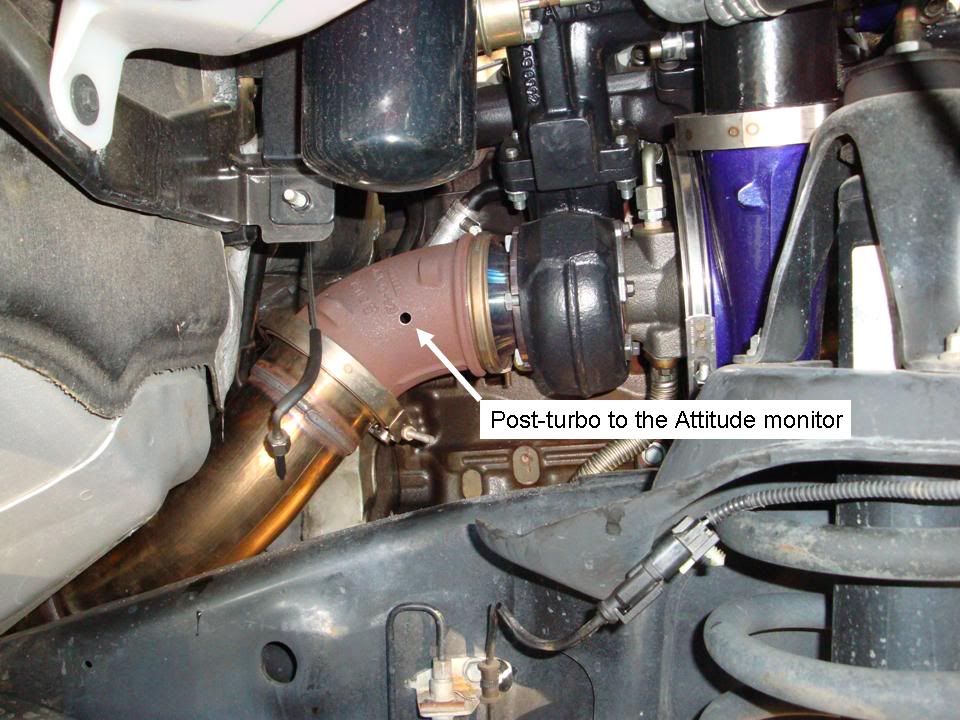

Now this is where we ran into a problem with the ATS setup. The location of the wastegate head was trying to occupy the same space as one of the AC lines. The required evacuating the AC system and removing the AC line until I could get a custom one made at a local shop. Here is the line I had to remove and the one I had had made to clear the wastegate head.
I contacted ATS regarding this, sent them the pictures and was reimbursed the $45 that it cost me to have a new AC line made.

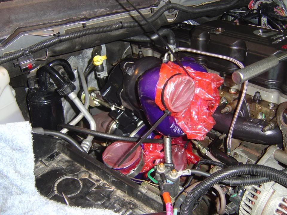

The BD exhaust adapter also presented a problem at this point. The kit called for moving the AC drier approx 1.5” toward the passenger fender. The kit came with two spacer and two new bolts to do this. The problem here was that you have to move something that is attached to the hard lines. This required bending the AC lines as much as possible without breaking them off the drier.
I don’t have a good picture of this, as I was getting pretty pissed off with all the modifications on the BD kit. We ended up needing to use zip ties to hold it in place until we could get it to the shop to get bent properly.

The ATS kit presented me with one final problem here. The kit comes with a 90* boost boot to go from the secondary boost tube to the intercooler opening. This boot is sized for a stock intercooler and I had the ATS intercooler that had a larger opening.
This required removing the ATS intercooler and re-installing the stock intercooler until the new one from ATS showed up, which was sent overnight.

The ATS kit attaches to your exhaust utilizing the existing elbow and no modifications are required on your exhaust setup. Simply align the elbow, exhaust and turbine housing and tighten the v-band clamps.
The BD kit made this require several more steps at this point. To attach the turbine housing to the exhaust, you MUST use the proprietary down pipe that comes with the kit. This pipe is 4”…now remember that both of us had 5” exhausts. What we found initially was that the angle of the downpipe flange did not line up with the turbine housing and made the downpipe hit the floor of the cab. Also, the flange was slightly bent and had to be flattened and modified a bit to line up with the exhaust. This also required using a 4” to 5” adapter to connect the two and cut the exhaust that he had installed.

The BD kit had issues as soon as we went down the street. The location of the turbine housing made it contact the passenger side spring mount as the engine flexed in the mounts. Upon initial application of throttle and upon braking, the housing was making contact and vibrating the whole chassis. The only way we could remedy this was the place a small piece of dynamat between the turbine housing and the spring mount.
Once this was fixed, we found another issue…..the downpipe. Again, due to the angle at the flange being wrong, it was trying to twist and was turning up toward the floorboard. This had to be fixed once the truck was taken to the muffler shop and had it all welded in place.
