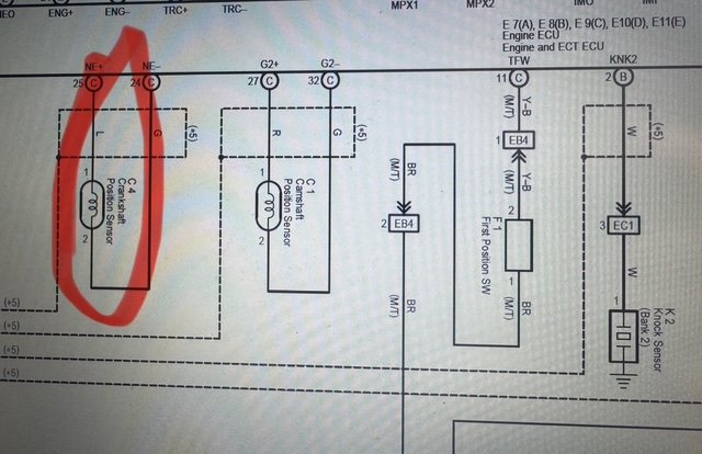

A lot of ECU wires are cut and not used due to the conversion, problem is I don't understand the Lexus system enough to know the list of ECU inputs that is required before the engine ECU is allowed to activate the compressor.

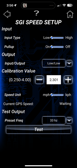

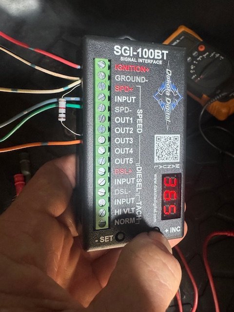

The cluster gage tacho has never worked- I have ordered an SGI-100BT signal converter. (I am hoping the engine rpm signal will be the missing ECU input required to activate the A/C)
I hope some-one knows and is able to share all ECU inputs and circuit bypasses required to turn on the compressor.
Some-one may also know how to connect the GM front crankshaft speed sensor to the SGI-100BT.
