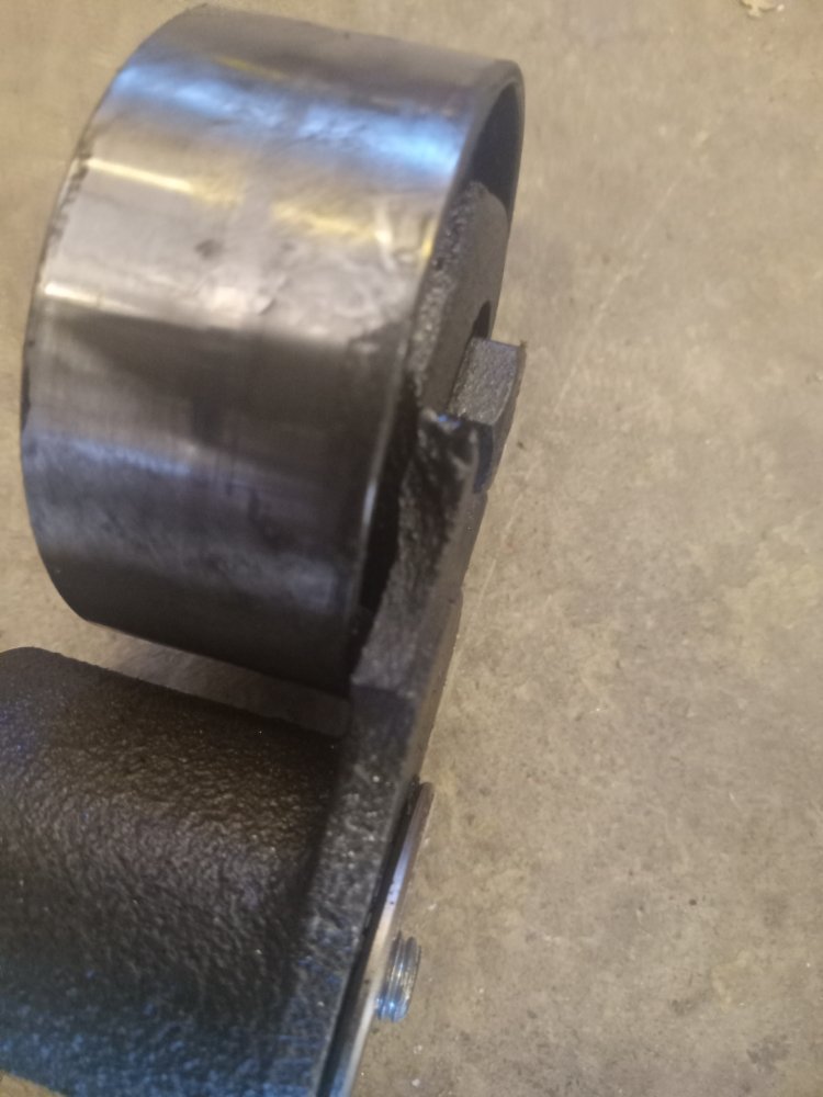

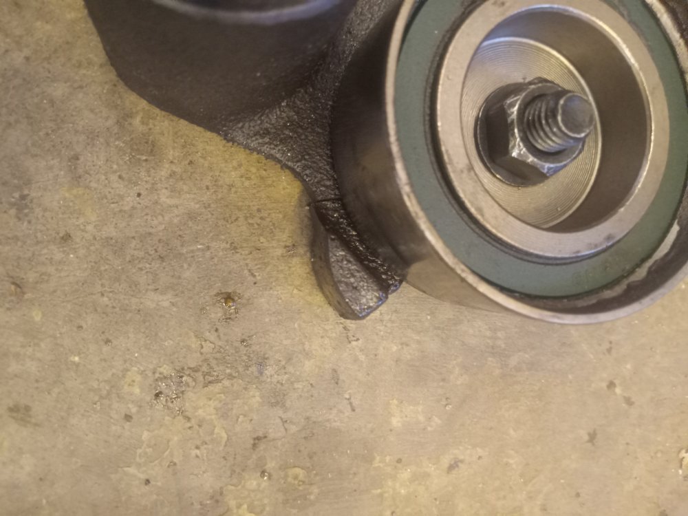

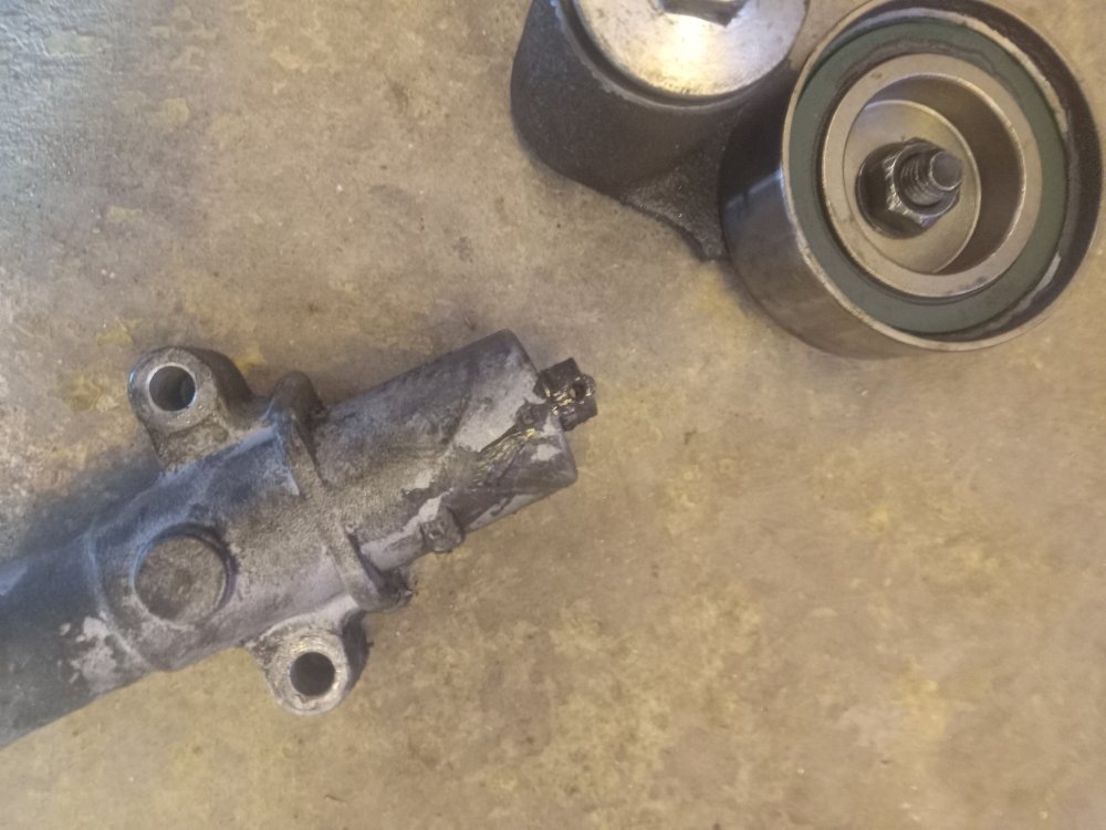

So last fall I picked up an 07 MDX for $500 for a replacement for my wife's 04 MDX which has 315k on it. They said it had a rod knock. We started it up and drove it on the trailer, it clattered really loudly. Even back then my thought was it just didn't quite sound like a rod bearing.
During the winter I did some research and discovered that it could also be a bad camshaft. I watched a YOUTUBE video where a dealer had replaced an engine because of a rod knock. The video was of a complete teardown of a 3.7, which turned out to have a bad camshaft. Even losing metal into the oil the bearings looked really good.
So fast forward to a couple of weeks ago I pulled it in to at least see what was wrong. First thing I did was pull the valve covers and everything looked OK. So I turned the engine over with a ratchet, and every so often I would hear this distinct tap.
So I decided to pull the oil filter and cut it open. It was clean, drained the oil and the magnet on the plug was clean.
So I pulled off the timing cover and found this 20240308_130838.jpg20240308_130845.jpg20240308_150700.jpg
Replaced those parts and it runs good, nice and quiet, hard to believe that the tensioner could make that much noise.
