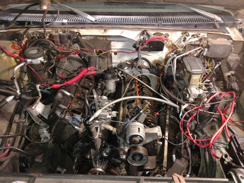

Center of pic you see the injection pump. See the clear line coming off it to the fuel return rail? Parts removed for clarity of picture... :wideyed:

I finally got the clear tube attached to the return - thanks WarWagon - and it showed a pretty clear blue with no bubbles . . .at idle. I asked my wife to hold the revs at 2000 and after 10 seconds, that pretty blue turned white with all the bubbles. Looks like we might have found evidence of the problem . . .
