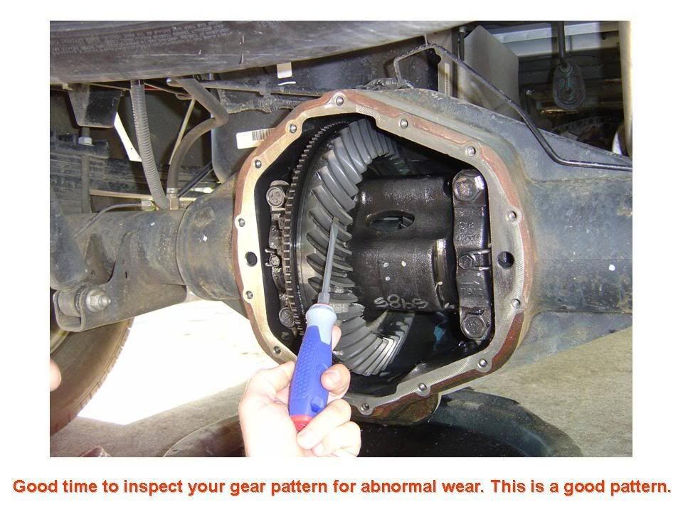

I would check the electrical connection on your rear diff housing. The speed sensor is located there and is read off the tone ring in the diff.

Sorry, this is the best pic I have of the rear. The speed sensor connector is located on the front side of the housing, right near the top.
Pull them apart, clean and dry them and apply some dielectric grease to the connections.
