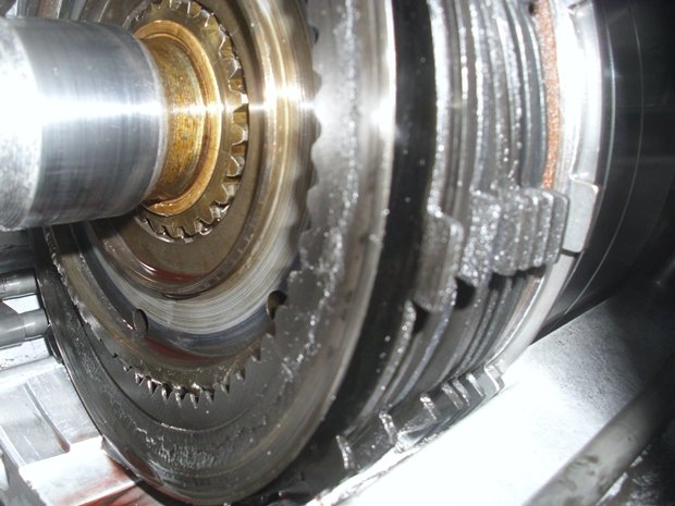

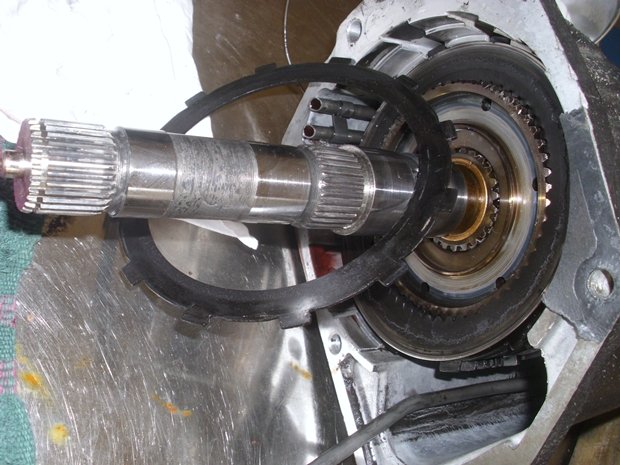

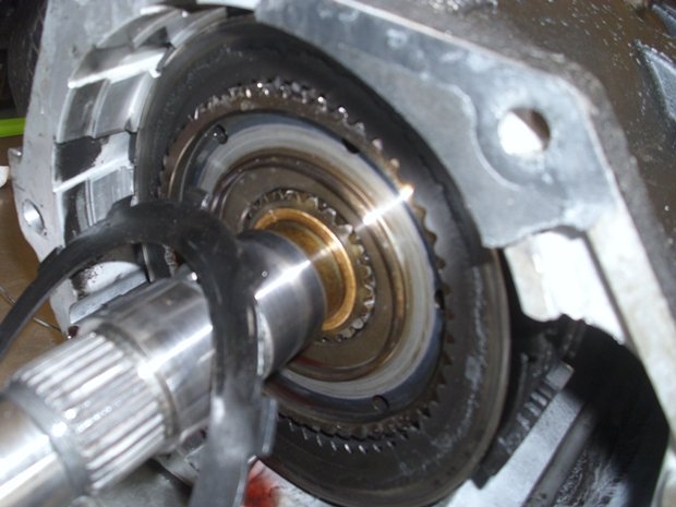

Well, finally dropped the transmission pan and valve body so far valve body looks good.........however; the fluid is burnt trans and converter clutches are shot and lots of fine metal particles in the pan too. So dropping the trans and pulling overdrive unit off something tells me it all started there either the retainer clip for that 800 lb spring snapped the overdrive overrun clutch and or the governor valve took a crap.
The 47/48RE are looking real good right about now, full manual valve body maybe a good idea but I don't know how I would like constantly shifting.
OK, I just tried to remove the overdrive extension housing and it is stuck and I mean stuck after analyzing the OD it must be stuck on the intermediate shaft normally it just slides off easy with a little tug and slight prying with screwdriver.
Checking the case the clutches and bands are fine so the OD & converter clutches are fried from whatever happened mechanically inside the OD unit that made my wheels lock..........
I have it out about 3/8" and that's all it will go I've used wedges and a dead blow hammer to no avail.
I've searched the web for days and nothing just a video on the output shaft being stuck on the governor housing.:eek:
Well; finally removed the OD extension housing which is seized to the intermediate shaft everything inside the OD is toast however; upon inspecting the case and its internals nothing wrong clutches and bands are like the day I installed them.

Final diagnose is that the overdrive overrun clutch failed in the "locked" position and when the wheels locked up and lucky the vehicles weight pushed through all of those ALTO clutches and premium steels in the overdrive assembly....
Now on too building this 47RH with full manual valve body and every 48RE part that fits "all six pinion planets" along with the shorter 48RE 4x4 overdrive making it a 47/48 hybrid.
