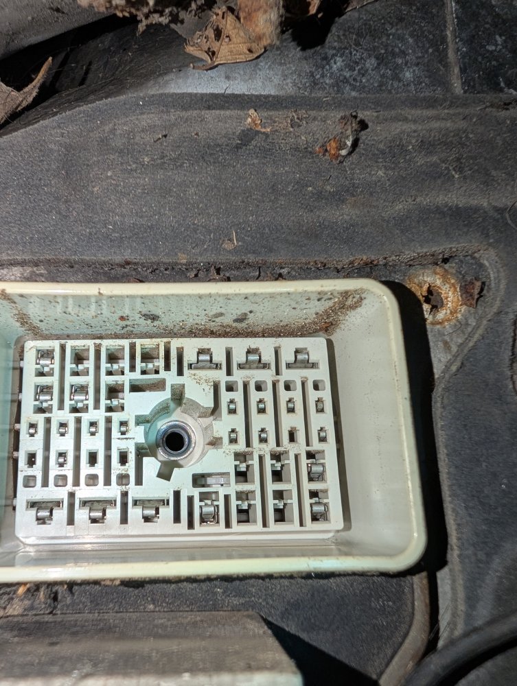

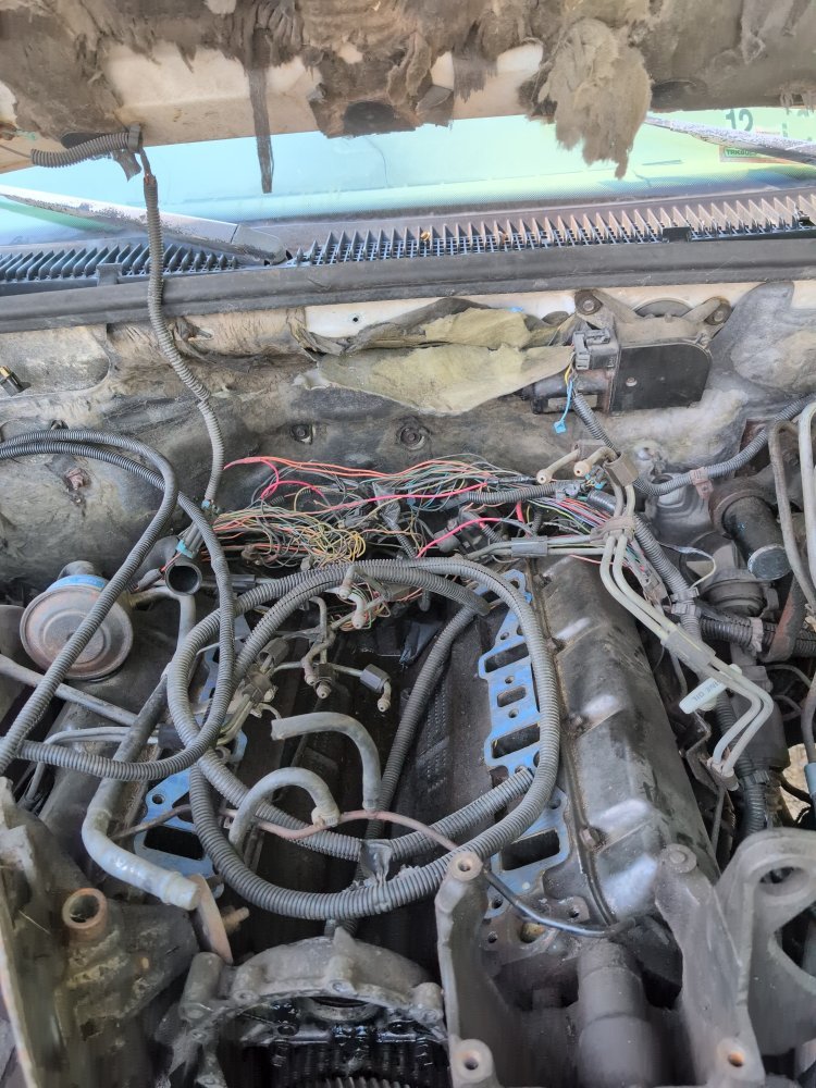

I recently purchased a 98 3500 HD and the wiring harness is a messc118c46d-3052-41fe-a646-581d82b60b83.jpg

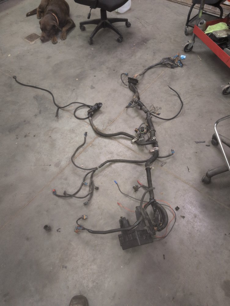

I pulled it put out and have another one out of a 00 3500 that I was going to swap it out with.
the one I was going to use as a replacement is from an automatic transmission truck and the 3500 HD is a manual transmission.

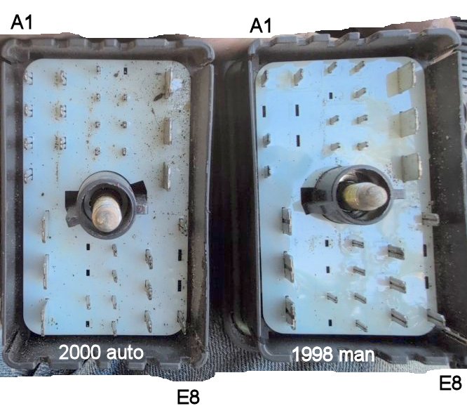

I was comparing the pins on the c100 connector which goes to the firewall on the driver side and the automatic transmission harness has a few extra pins that the manual transmission one does not. I'm guessing this will not be a problem. the only pin that I have found that is missing from the automatic transmission harness that was in the manual transmission harness is something to do with diagnostic signal ABS diesel.
I found that because I have a set of factory manuals and was comparing the pin outs.
also on the harness where it plugs into the ECM I noticed that there are more pins on the automatic transmission harness then the manual one.
from what I can tell, there are all the same pins that are in the manual. transmission harness are in the automatic transmission harness. there are just extra ones in the automatic transmission harness.
I am thinking that that will not be a problem because obviously there's no female side of the pins on the other connectors.
has anybody messed with this before? can anybody shed any light?

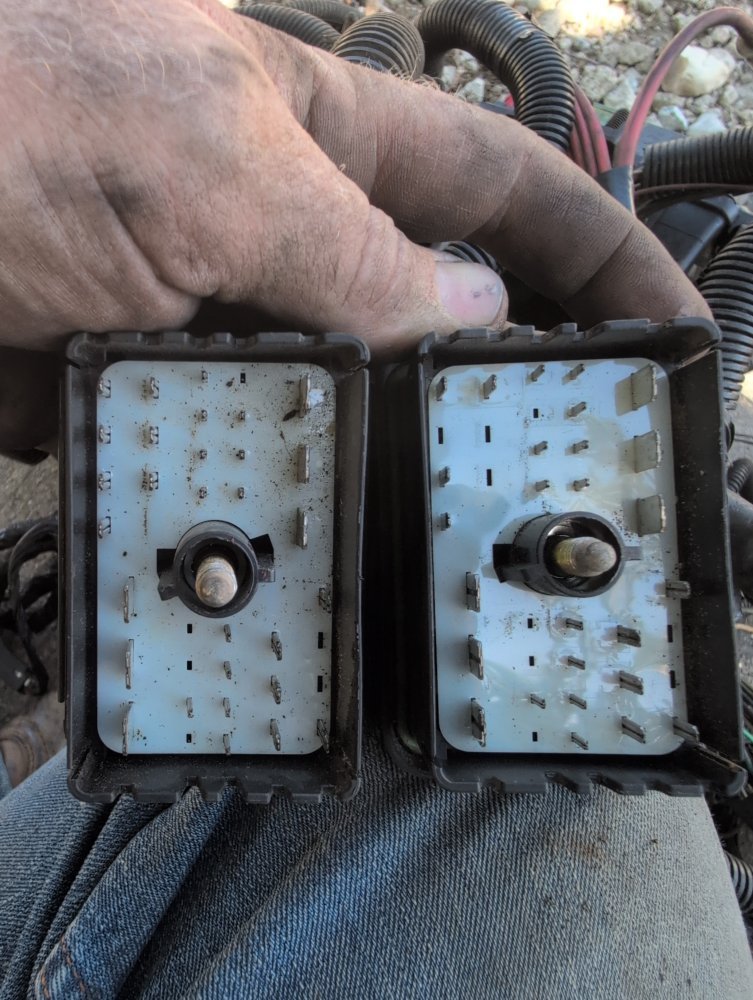

automatic left manual right
If your just using the under hood harness, you should be fine. I would de-pin the one for the ABS and put that one into the one your using so just in case you ever want the ABS to function. also without it, the light will be on in the dash too. on the 2000 one, some of the connectors that go to things like the ABS and other sensors might be different configurations. be sure to verify this.

I checked and all of the connectors seem to be the same other than the one from the automatic transmission obviously has a whole bunch of plugs for that.
A2 - AUTO TRANS 12V. IGN - NOT NEEDED
B2 & B3 - NOT USED 3500HD
C2 - PARK/NEUTRAL SAFETY SWITCH - NOT NEEDED
D1 - ABS DIAGS GOES TO DLC - 3500HD ONLY
Are there terms on the firewall conn. for any of the above terms?
so I should probably try and figure out the abs diag one
also just curious how did you find these It took me forever to find the right page in the manuals I have to figure out what goes to what

Did you see my question about existing terms?
FYI the FSM's are full of errors.
so the other side of the plug? I didn't look but I can when I get back home. what would I need to do get the abs diags to work

I got the wiring all switched around thanks to Glagulator helping me sort out the things that needed changed. I basically had to change some stuff for the vss and reverse switch since the harness I'm using was for a auto and truck is a manual. also had to re do a few things for the abs. going to get it back in the truck and start on getting the inj pump in so I can see if this all works.
