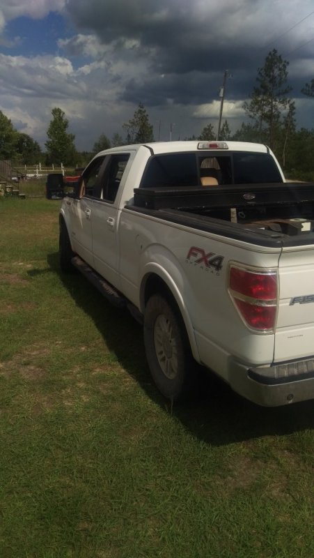

Gotta do my timing chain. (Errr, neighbor mechanic doing it). Is sealed power OK, or go SA gear? (his recommendation). And where do you get SA gear. 155k miles. New to the forum. 2013 loaded......loaded with more to go wrong!15606313670221285517463.jpg
Sealed power on RA is in my cart. $107. Haven't checked out yet. Running into more questions. Gasket sets are more than that. Gotta change vacuum pump also. Truck had a hard life. Spent first 125k hauling farm equipment for a rental place in Louisiana. Looking at it all, looks like I should replace more while he is in it. VVT solenoid actuator, spark plugs, anything else that has to do with timing/fire. Ugh. Knew I should have got the 5.0.
