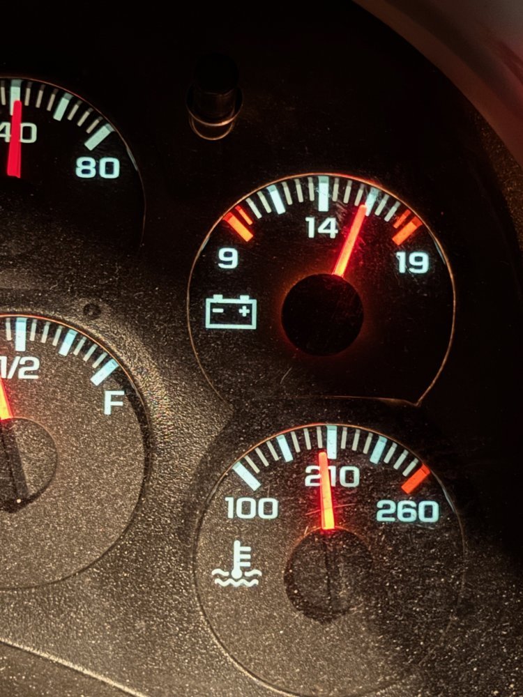

Hey guys, I know I can ask on the trailvoy forums but I'm not a member there "yet" as I had posted in another thread we had the battery go bad on us. the battery was dated June of this year and somehow got smoked to where it would not take a charge. this was a couple weeks ago. I since swapped it with a spare battery I had and when I got it home, noticed that the voltage gauge was at the 3/4 mark indicating an overcharging condition.

driving around tonight I noticed once again the gauge is back up to the 3/4 mark (14v is in the middle), got home and grabbed my meter. probed the battery and was seeing 14.7 with all the lights and AC running. turn it all off and it went up to 14.8v at idle. I even went as far as plugging in my Bluetooth obd scanner and looking at the ECM data which shows 14.5v.
to me this is kinda high and might have caused the other battery to get smoked.
looking online all the info I can find on this is for the 2007+ variants which have a sensor on the negative battery cable that is common to go bad and do this exact same thing. problem is this is a 2006 and does not have this sensor.

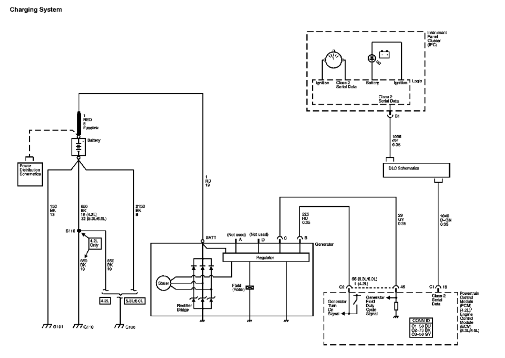

I did find a diagram for the charging system. doesn't tell me much other than confirming that the ECM/PCM controls the alternator through a pwm signal. looks like I might have to go through all of the power and grounds along with probing for any voltage drops between the battery and the PCM. from what I can tell and reading between the lines, if the PCM isn't seeing the right voltage it will just tell the alternator to output more!
This is where I really have to be careful since this thing has a CAN BUS system. it's not gonna be fun! Here is a pic I took tonight of the gauge and a snip of the diagram

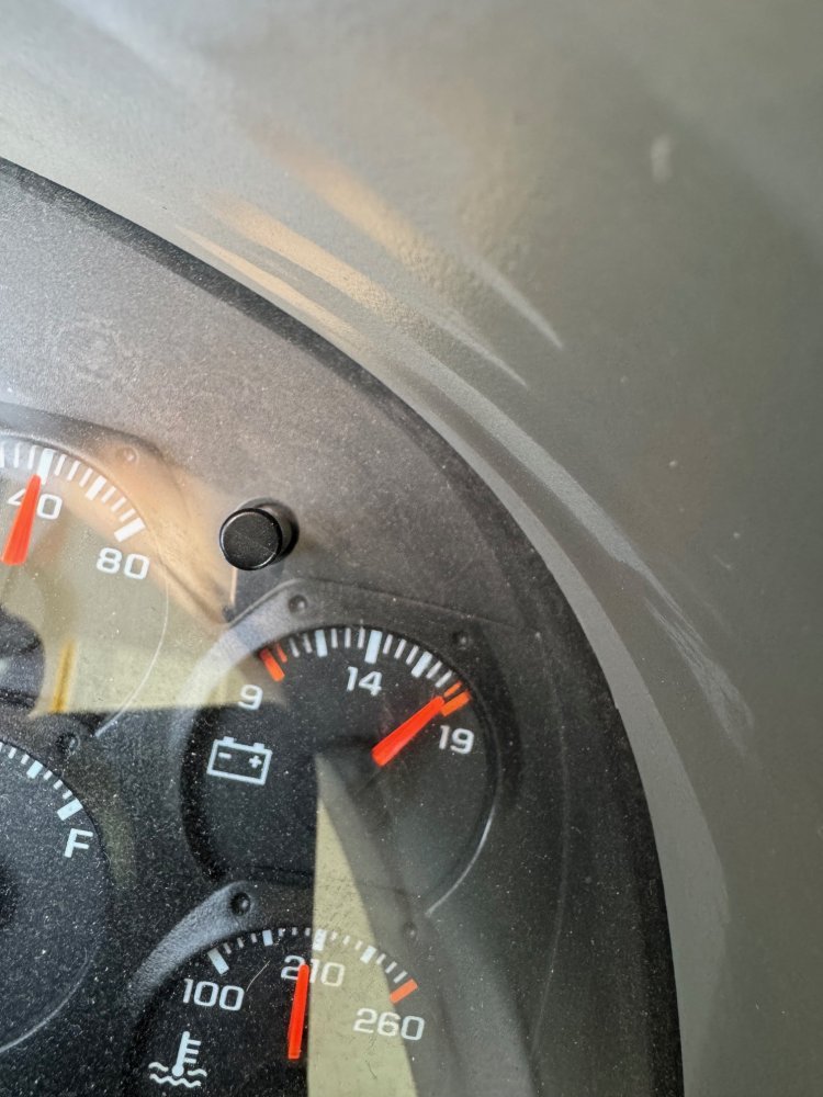

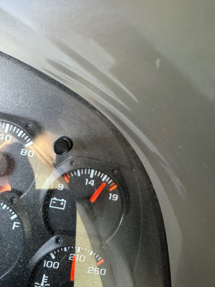

Welp I got out there this morning and seeing this... think there is something else going on here. my multi-meter shows 12.6 with the key off at the battery and still 14.7 at idle. but look at what the gauge is reading. first pic is key on engine off, second is at idle. mind you it's been running and now at full operating temp.
Key on engine off.
Engine at idle

for piece of mind I got my amp clamp out and measured the amp output on the wire to the alternator, battery, and main fuse block. the alternator only pushes 26 amps at idle, the battery is only getting about 4 amps and the rest is going into the main fuse block to the vehicle. So I am deeming the issue resolved with the exception of a faulty gauge in the cluster.
