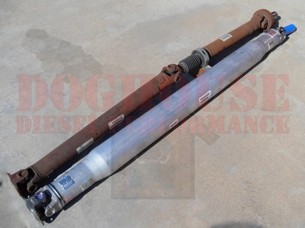

Check that center carrier bearing.
With that many miles, that thing is probably shot and causeing all your problems.
This is the part that is the #1 cause of vibrations in trucks with the 2-piece driveshaft.
We see EASILY 2 out of 3 trucks that come into the shop and have over 70K miles on them have a problem with this carrier bearing.
That's why we have this....
Unfortunately, we don't have them for trucks with the NV5600, so you're kinda stuck replacing the carrier bearing.
Dang, mines got 123xxx miles so its prolly WAY over due....when you gonna build that for the NV5600??? thats a smart way to fix that problem!! and cheaper on u joint repairs too!!! I sent you a pm cumminalong, ill get back with ya today sometime prolly...
