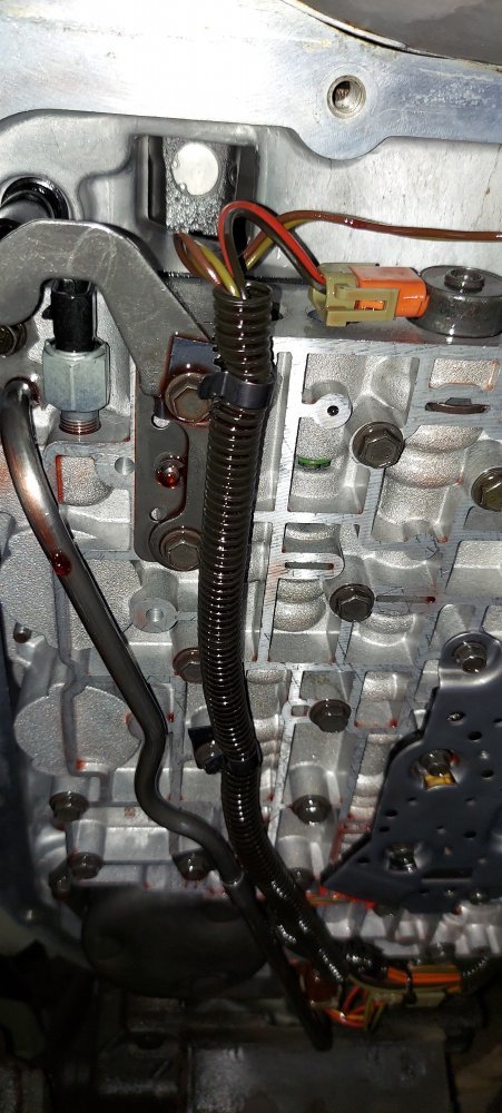

Gonna post a few pics/ video and hope somone can help me towards the light. Not sure if the tranny is the culprit to the rough symptoms of rough running. However seems likely if not just TPS /other bits.. yet the trans fluid has always leaked slowly and consistently im thinking by the wiggle play in the main harness ( from outside to in the inside. Driverside rearish. The main harness input connection round shaped w many pin prongs.. its always soaked with fluid. Ive sprayed electrical conect. cleaner graciously a few diff times followed by air drying after ect in hopes that itd remain dry n happy but regardless of its inner rubber weather apron and fit that fluid just finds it way back in and that connection is wetter then mothernature is when i step outiside in the winter... ***anyways***
im wondering if the wiggles i now see is due to missing seal ring or somthing??
And if seal is specially rare type or breed should i just use some sorta batter- rtvcaulk and beader up DIY fashion like martha stewie would?

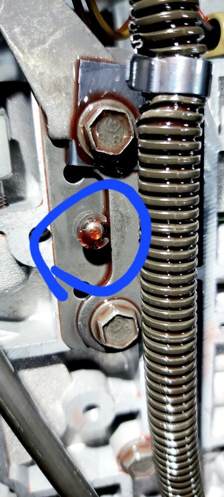

Also in the video or pic i noticed a c clip that is clipped at the end of a rod or somthing just barely protruding like ¼" out of surface.. all looks normal except i can clearly see a dirt /dusty outline of where itd sit flush (as if intended when installed or assembled. Not sure if i should push c clip down so its flush or if its fine how i found it... appears to be the only one c clip visible amongst the h
Sorry folks! Currently struggleing with wifi coverage on my phone... circled the c clip with blue circle to help define my question... i really need to bolt the pan back up ASAP. Just wondering if this clip is how it should be or if its coming loose somehow do to wear and tear or somthin.. thanks!

Welcome to the forum @Yousiferrous I'm no tranny expert, but if that C-clip is in the grove properly I wouldn't worry too much about it.
as ak said, the harness is probably due for a upgrade and replacement. they all start leaking at some point in their lives. a lot of the times they leak internal through where the wires and pins to through the actual connector. spray with cleaner and air dry once again for the mean time, then goop some dielectric grease in there to help keep the tranny fluid off and causing a short until you can order a new harness.

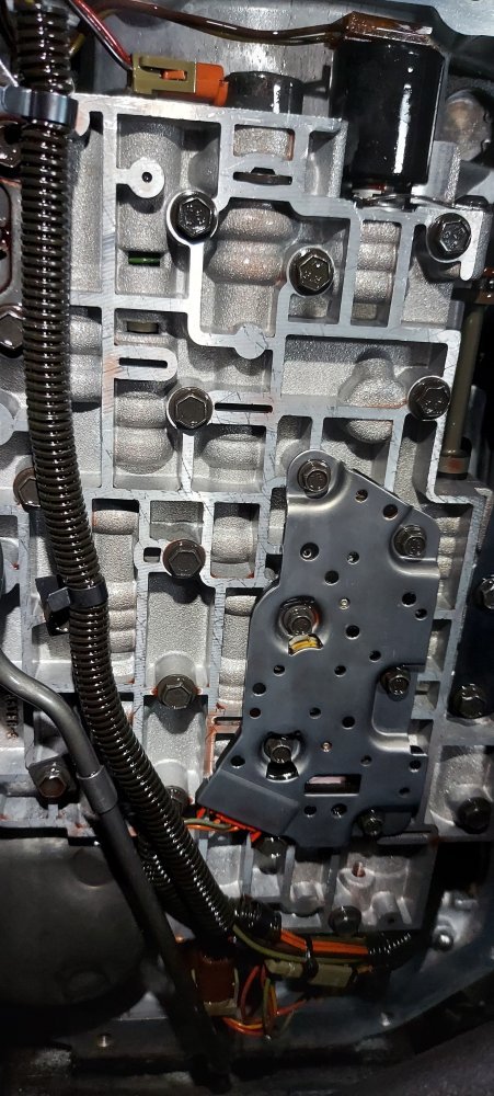

Here is a video of the stuff im confused/concerned about with prolly better view of what and where the bits are.
I don't think it came through. upload the video to youtube and then copy and past the link here. that's the easiest way to post videos.

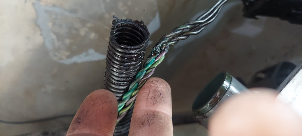

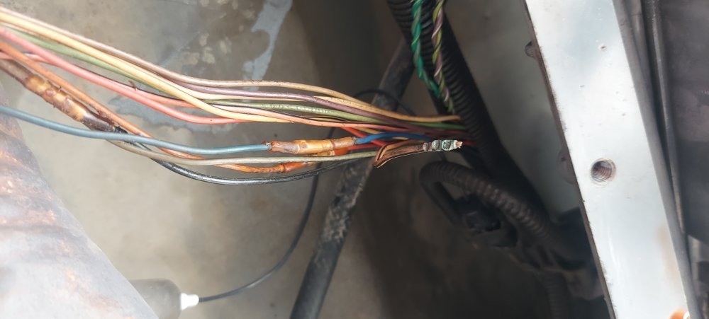

. That should do the trick.. thanks again everyone!! By the way. Ive since just inspected the main harness to the tranny and low n behold sure enough about a foot or so up from the connector (keep in mind this section was well inside the thick plastic corragated wire shield armor) first fault i noticed was two wires side by side both exposed like a bite was nibbled into them both... prolly assuming they made contact with exhaust and melted long ago... anyways i can see the potential of these two making momentary contact whenever goIng over a bump or somthin.. and about a few inches up one wire is completley exposed hanging together only by the copper threads... and another fing wire wich is either completley disconnected accidently or purposefully in the past by someone.... keep in mind i very carefully handled this harness as i pulled the corragated plastic armor tubing to find all of this... imma upload some pics here in a moment.. honestly surprised i have never gotten any check engine lighted codes.. id be even more surprised if this isnt the actual cause to my mysterious list of symptoms of truck driving like it was on its way to the pits of doom..
Heres some pics.... idk what im gonna do atm cuz i cant afford to go buy anything atm got maybe 10 bucks anyways thinkin bout performing a temporary electrical surgeory vs. Just some liquid electrical tape to prevent any intermit shorts.. im gonna clean these up with a bit of iso on a rag and decide..
Heres some pics.... idk what im gonna do atm cuz i cant afford to go buy anything atm got maybe 10 bucks anyways thinkin bout performing a temporary electrical surgeory vs. Just some liquid electrical tape to prevent any intermit shorts.. im gonna clean these up with a bit of iso on a rag and decide..20221021_151210.jpg

I believe those twisted wires are the speed sensor wires and need to stay twisted to read right, so be careful there. I've heard that a rebuild kit for the older trannies comes with the newer style and the old style is unavailable
clean up the wires and apply some liquid tape to seal them. pull them anyway so they are not gonna be touching anything, but don't untwist them.
the small steel pin with the c-clip. leave that alone. seeing a pressure sensor without any connector and judging by how clean the valve body looks, has someone has been into this tranny, rebuild it, or did a swap where it may have came from a different year truck and they just installed the old harness and ran with it? what is it's back history? is the tranny slipping any or not shifting properly?
on the harness main connector, it's loose because of a main clip that held it into place is ether missing or broken. I believe the clip is plastic and part of the harness. you will have to first disconnect the plug on the outside and then push it inward to slide it out. there should be a o-ring or seal of some sort on the outer part that seals it to the body. you can "only for a temporary" fix, pull it out by pushing it into the tranny. clean it's surface and the surface of the hole in the housing so it's dry and oil free. then apply a thin layer of RTV silicone to the hole, not on the connector. re-install and secure it as best as you can. leave it to allow the silicone to cure. then put the pan on and refill.
word of caution: you do NOT want ANY silicone getting inside the transmission.

I had to work with what i had at the moment. Just carefully cleaned and InsIlated the wire exposures
