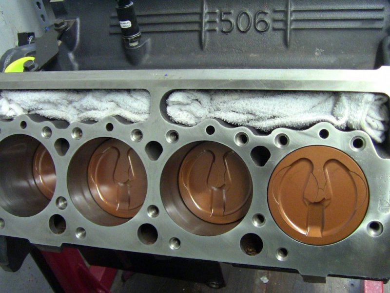

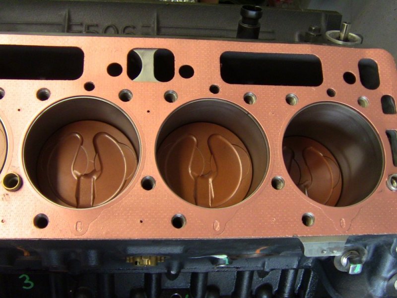

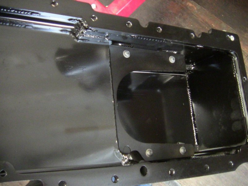

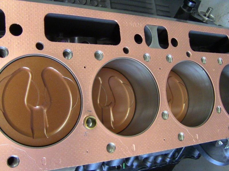

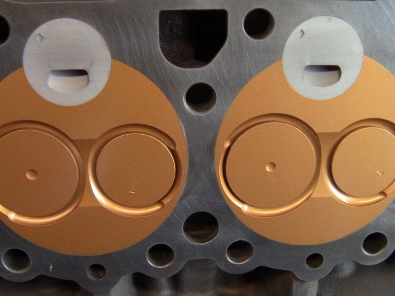

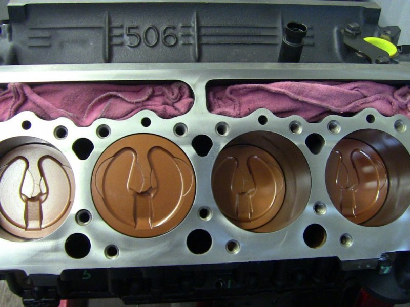

This person want's to start with stock rockers and be able to upgrade later so I machined pockets in the pistons. Oil pan is stock capacity. Yes, the heads are a stage 2 porting, valve unshrouding, and fully coated, chambers, runners, valve stems. I coated everything that could be coated, gear drive, oil pump, etc... I sent the rings to total seal and had them machined and fitted for gapless 2nd ring, it keeps the soot out of the oil almost 100%...

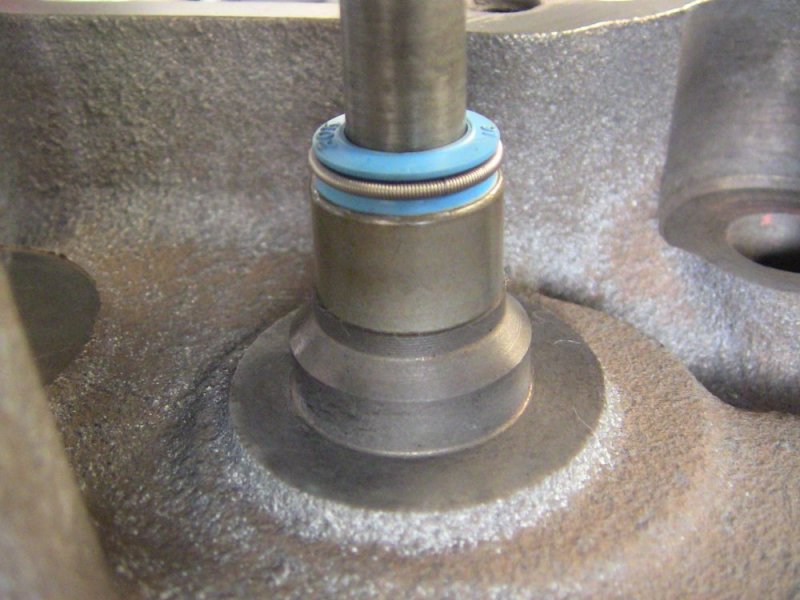

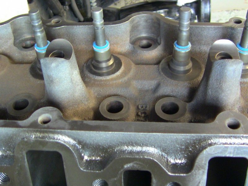

The pics of the head, around the valves, are worth a second look.... ;)
You mean the cnc unshrouding cuts he made? Just to notice them Incase someone missed that feature or do you see something wrong. I noticed a tiny piece of masking tape that will wipe off before install in second pic of head near intake valve side, but nothing bad. Around on on valves.
