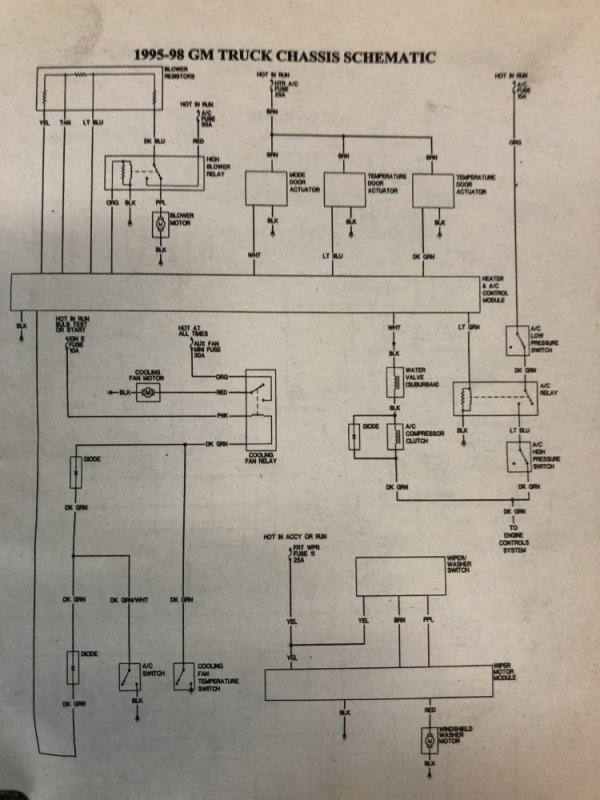

The top wiring schematic from the Chiltons manual shows it.
Yeah, the three lower speeds are run through resistors, the high speed fan is run through a relay and is full battery voltage. It is the switch itself that has the four positions, three positions are through the resistors and the fourth is through the relay.

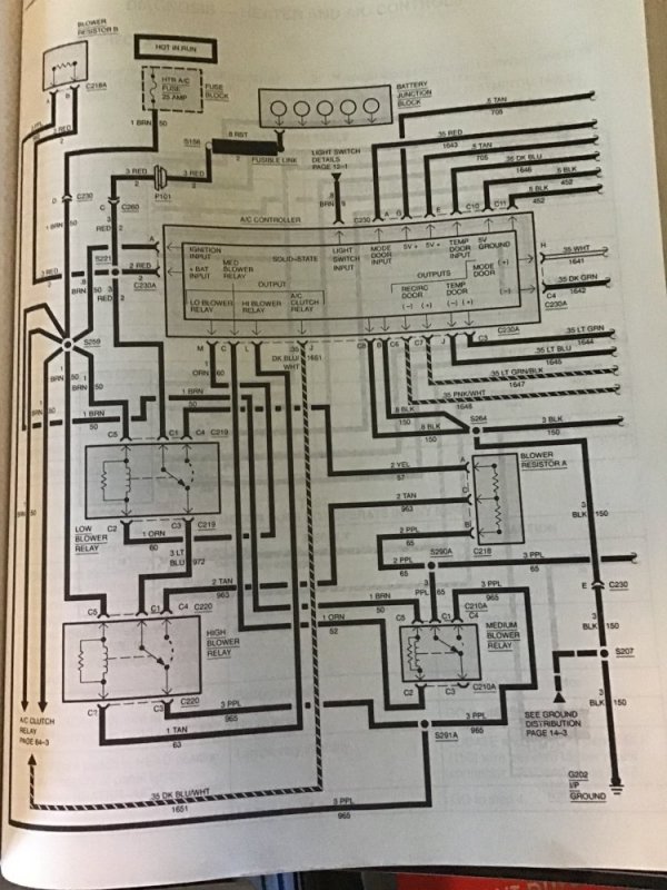

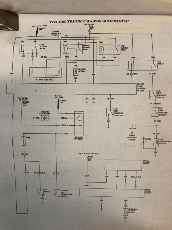

All 4 speeds run through relays on the 1994, 3 speeds in the case of my 1993. The top drawing is from 1995-98. It appears to have different controls.
So its a matter of which relays are on the get the in between speeds. For instance, 1993 the low and high relay are on for lowest speed, for the medium speed the high relay drops out, for high speed, the high relay comes back on and the low relay drops out.
