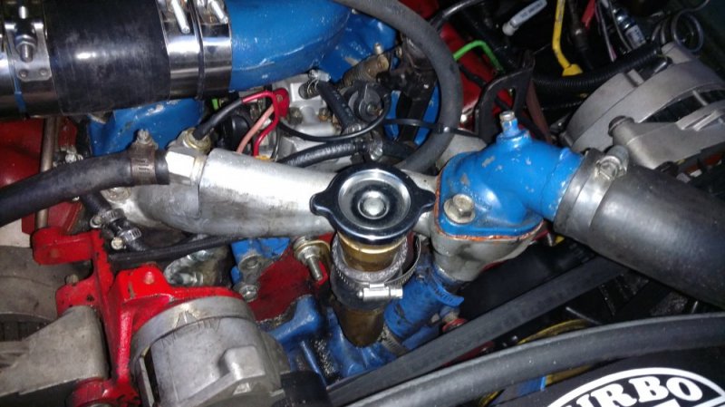

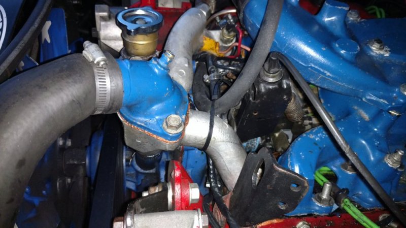

I've been reading and researching and my head is spinning. I am running a single t stat housing. I've no clue if it's a bypass or not type. I'm running the high output pump. Do I want the hockey puck t stat or the unshrouded one, with 2 springs? Anyone have the part number for the 180 degree one?

Yesterday went fubar. Drove up into Vermont. Gauge started bouncing. Was 2 gallons low. Added two and left the cap loose to slow the leak. WRONG! Sprayed coolant all over the air cleaner. Big white cloud, two low again. Bouncy gauge...
Two more in, (I carry a lot), and a tight cap, was good then.
All the t stat parts are here except the t stat.
Today I drop the fuel tank and pull those electric fans.
Ordering an AFE dry media BHAF air cleaner and cover.
I always pack along an extra gallon of coolant, an extra quart of oil too, not just in the K3500 but in all of Mine wehicles.
A person just never knows.
Good that You had more than one gallon along. Made a happy ending of what could have been a pretty miserable journey.
did You figure out where the leak is at ?
Putting t stat gaskets in it and will go from there. The water pump gasket and the hoses and clamps are new.

T stat in old one was 195 degree. Double gaskets all around with gasket shellac on the metal sides.
