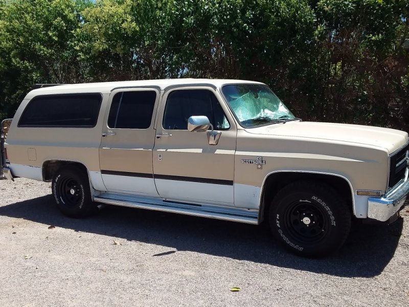

What im driving,
Jbhvnz
Member
22
40
1986 suburban, the list is exhaustive
400 horse small block, summit 202,160 heads, headers, msd, comp cam(268h)
4l80e trans/compushift computer (lots of work)
12 bolt posi( eaton new gear unit)
Derale trans cooler
4 row core alum rad
All new suspension w/ air bags in rear
Leather buckets

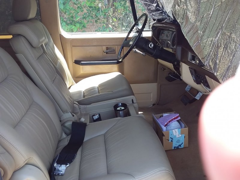

Sound deadner/ new carpet
Elect fans (3) on separate relays, 2 on condenser 1 on trans cooler
Dual batteries
A/c blows cold in rear, warm in front, suspect stuck expansion valve, anybody?
