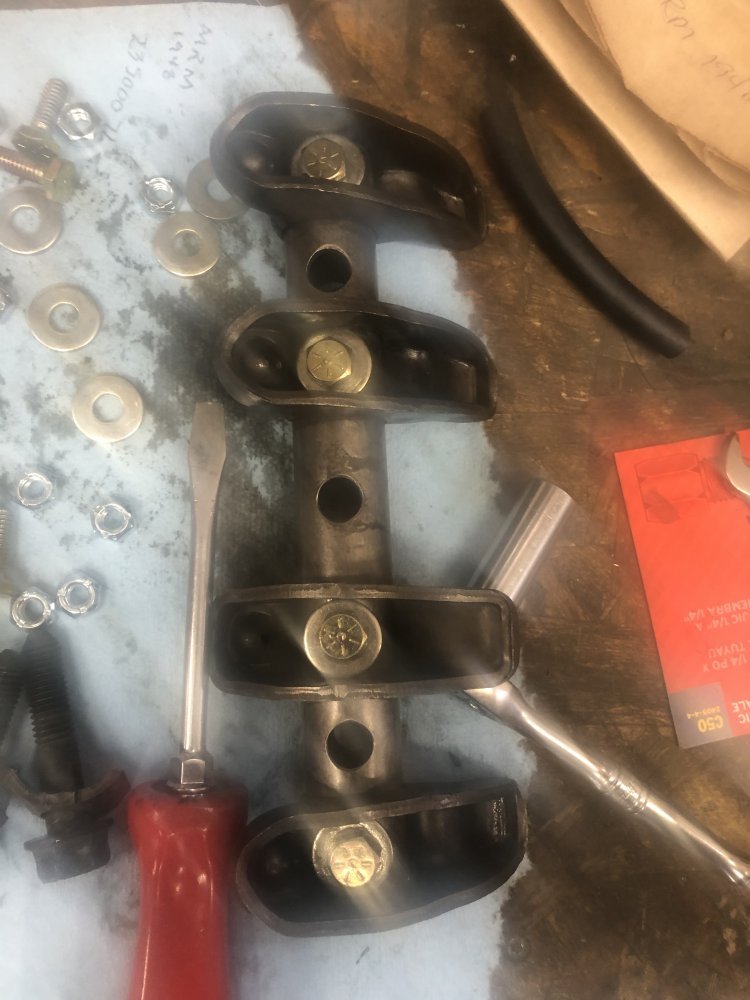

Pulled the rocker shafts.
Got the grade 8, 1/4” X 3/4” bolts and the thick washers. Used grade 5 steel self lock nuts.
Wedged a screw driver between the nut and the inside of the rocker arm tube.
I read about this someplace on the innernet, probably in here but I dont remember.
It most certainly is a lot easier to clean off the gasket goop from the back of the cylinder heads with them rockers out of the way.

Did you have to shave the washers on the sides to fit them in the rockers? I might do this the next time I take mine apart Been thinking about investing into a cherry picker to pull the engine so I can do my oil pan gasket sometime
No, but there were two different size thick washers in the hardware store.
The ones that I chose to use are 1/4” X .750 OD. IIRC the other 1/4” size washer was a little larger and would not fit between the sides of the rocker arm.
One thing that I did not think to look at was the metric size thich washers, if maybe they may have been a little smaller OD and also slightly smaller ID so that they would maybe have been a more precise size on the bolt.
These warshers do tend to drift ever so slightly one side or the other.
What I do see, within the arms of the rockers is, there is some slight wear to one side of the arms so I guess being an exact fit Is not such a big deal.

I've frequently used metric washers for different applications. Sometimes on a fastener website you can find all of the specs.
Would serrated head bolts work to eliminate the washers?
Did you use nylocks?
I was curious about nylocks being oil resistant if that's what you used.
Didnt think of the serrated, washer head, bolts. In a 1/4” size bolt the washer head might be too small.
There also might be metric equivalents that could work as well or better.
I shied away from the nylok nuts. That plasticated stuff them buttons is made of deteriorates with heat, oil and time. I didnt want to take a chance with that happening with the nyloks.
Also, there are two styles of self locking nuts, that I am aware of.
The one style has what looks like a rectangular dent midway between top and bottom of the flats.
The other style has what appears to be somewhat of a pinch on one end of the nut.
The ones with the pinch on the end of the nut is the ones I used. Less resistance until the lock is obtained.
I did have to use four of the ones with the punch mark midway of the flats. I used those on the end of the shaft rockers.
Two different sizes of screw drivers for lodging between the nut and the rocker tube wall. Used the smaller one to get the nut most the way engaged then the larger one to finish the tightening sequence.

J_dude
230
715
Southwest Saskatchewan
Technically there’s at least four common types of locking nuts that I know of. NyLock, Flange-Lock, “Cone” Lock (the ones that are pinched slightly on two or three sides), and then the ones you mentioned with the little rectangular dent, which seem to be a variation of the cone lock, but the pinch is in the middle of the flat sides, rather than on the top. Not sure the actual name for those.
