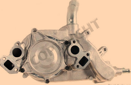

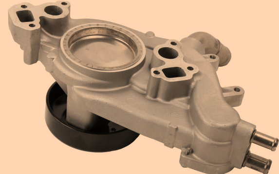

@JustinCydeher Welcome to the forum. help me understand what you are talking about when you mentioned
my truck froze up it pushed in the back off my brand new water pump
I looked online for a couple of photos of the actual pump to see what were are talking about. are you referring to the center part of the pump where it looks to have a press fit or bolt on cover? is this what got pushed out and is now leaking?
two photos below: first one is an AC Delco pump, second is an Airtex brand pump.
View attachment 71995View attachment 71996
Yes my pump is like the press in. I put it back in and put RTV on it and it held for about a week and worked fine.the only other damage I think was it busted the thermostat housing and my heater core. I have replaced both
