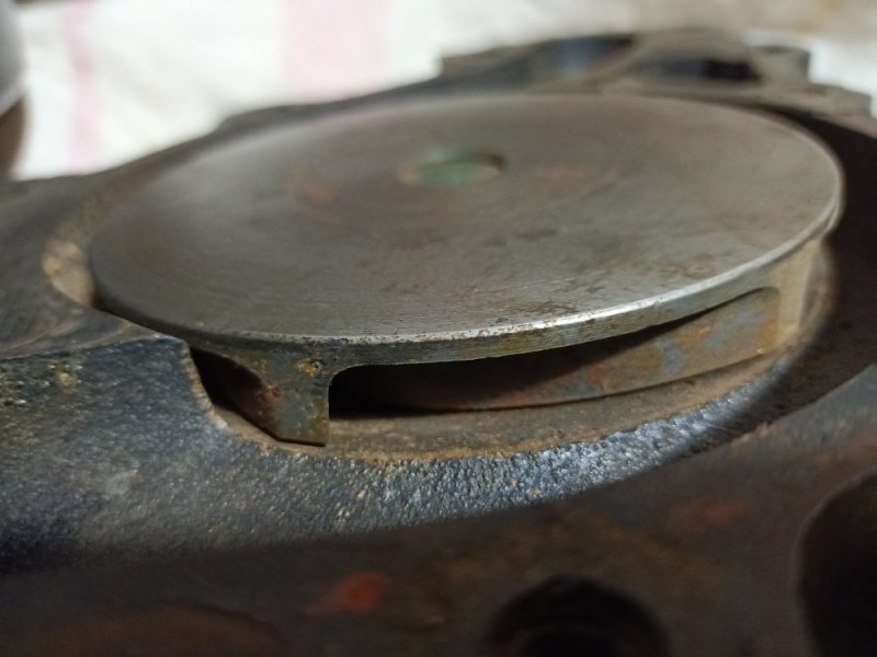

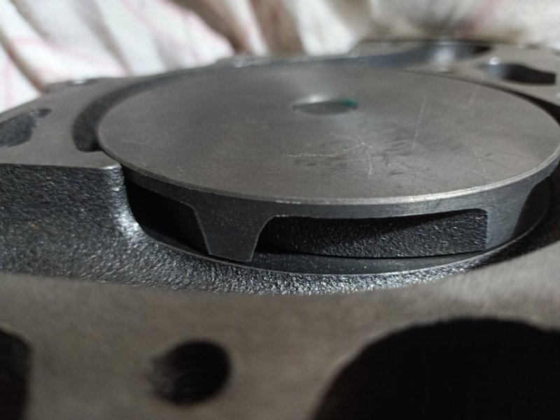

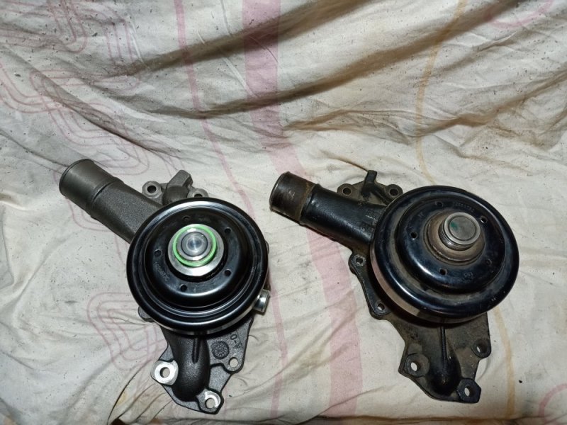

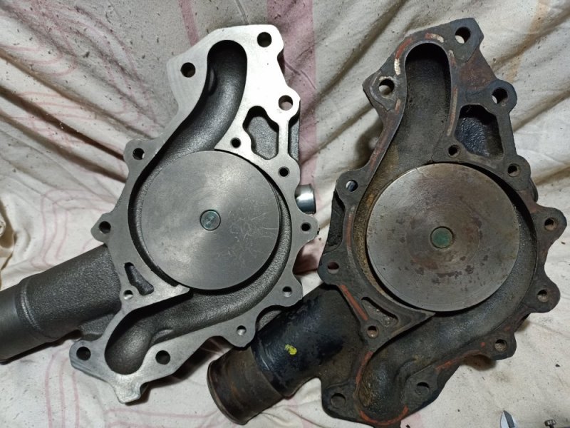

I now have two pumps in my garage, and one is installed in the Hummer. The native pump 99 started leaking., I bay noname pump from ebay $50. The engine started to warm up. I ordered a pump from a local market using a number from a Hummer. Arrived the pump from China.
Will install on Hamster or throw it out?
@denata NOPE. Send it back and get the AC Delco. Your hummer already has everything else ok Except the bypass restriction fitting. Do that also while the water pump is out, it screws into the water pump.
i see multiple differences Marty you are correct - but to be fair I already done the -in my hands comparison, So my eyes go right to them.
Mark down the road bought an airtex and had me help it go back together middle of the night on a Sunday a couple years back middle of the summer. Only a few parts stores open and none had the AC Delco in stock. So we put it on so he could go to work in the morning - plumber service truck. He called me at lunchtime Monday- he would pull over at 210° because he blew the previous engine from overheating. Dual aftermarket temp gauges on top of the dash with a fuel pressure gauge in the middle, all digital I was kinda proud of him! Haha. He convinced me digital gauges can look ok.
Anyways he stopped at a napa on his way home and bought the Delco. We changed it that night. The next day he saw the difference instantly. Autozone refunded his money on the airtex when they saw the receipt from napa and he showed the manager video of the temperature difference on his phone. Airtex had drivers head 4° colder than normal and passenger head 9° hotter just driving on flat ground. C3500 with 11’ utility bed. Probably weighed around 14,000 lbs. when he pulled the hill coming out of Vegas valley he saw 202 driver and 219 passenger. That is a 3 mile stetch that soows semis down from 70 mph to 45/50 when loaded, no clue the angle. His normal temperature is 190° and the two sides stay same flat ground and go 1 or 2° hotter. He said he never sees a 3° difference even when he towed his ford dually pickup up hill on a car trailer.
