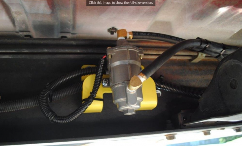

I decided to keep the delphi pump and do a FASS fuel pressure regulator. Did a return to the tank and regulated it to 10 PSI. I have a light I installed in my truck years ago to let me know if fuel pressure went below 4 psi just so I knew if lift pump quit. When pulling hills with trailer I would get a flicker once in a while with walbro and more flickers with factory lift pump. Pulled the toy hauler last night up I80 towareds Reno to Emigrant Gap from Sacramento area. Truck pulled great and light never flickered once. Pretty happy with it. Now if it lasts more than 2 years I'll be happy. Good thing is, as of now, Delphi has a lifetime warranty on these pumps. 20180628_123541.jpg

That's a nice clean looking setup.
I have several of the higher pressure fuel pumps setting around, new in the box, for the higher pressure gas engines. If this new Carter system I have fails, I might get a regulator and set up one of those pumps and see how long they will hold up.

That is, indeed, a nice looking setup. The first thing I think of, though, is big gobs of slush and ice chunks hitting that glass and wasting the gauge, as it rips it off the frame. The I looked at your location and, alas, you're away from the salt belt and in an area where you're allowed to drive your truck year round without fear of the above (and rot).

Yeah I thought of that and may change the location. Problem was I was in Canada fishing until Sunday and had a camping trip planned for Thurs after I got back. Reg. was waiting at the shop when I got home. So I had 4 days to get reg. installed and load trailer for a 4 day camping trip. So this was an easy location and I can see the fuel pressure without crawling under the truck. When I did the intercooler setup on my truck 13 years ago people said the same thing about something ripping it off or going through it. I said well if that plastic skid plate shit can last this long without damage, I think the intercooler will be fine. Hell 13 years later still the original one I installed. And I figured if something did damage it I was only out $100 and some dollars. If I leave it there I will probably put an aluminum shield or something in front of it.
