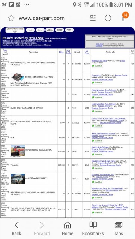

So as my other thread stated, I spun a bearing in my 97 454 vortec motor with low miles on a rebuild.
The crank has already been turned once, I assume I just need to replace it. Is there anything spcial about the vortec 454?
I found a 95 tbi 454 with 78k miles forsale, would that bottom end work with my vortec heads and a cam?
