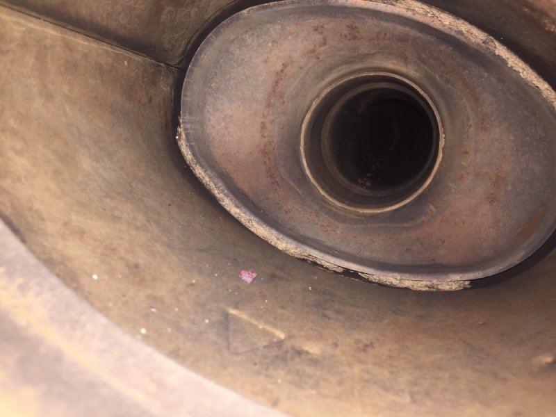

Here recently my 98 has been acting up once again. It started out as just a little miss at full throttle and now it’s turned into no power at all. It will run fine at idle and idle up perfect in neutral. If you put it in gear and try to drive it, it instantly loses all power and hogs down. Camshaft PS has been changed plugs wires cap and rotor have all been changed recently. I tested the TPS and it tested good. Ohmed out all of the o2 sensors and they tested good. Cats aren’t stopped up. MAF sensor has been cleaned at least 4 times. It was making the manifolds glow red when I pulled a trailer with it the other day when it started acting up. I have a picture of the manifolds
