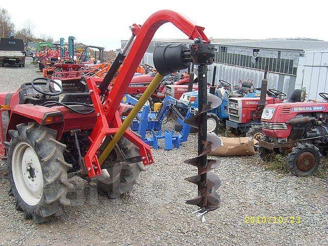

I think so: Kubota, Iseki,Yanmar Shibaura 15-25 hp = 5-12k$ + hinged hydraulic turner and auger for another 2-3k$. Usually a mini tractor complete with a tiller.
For example:

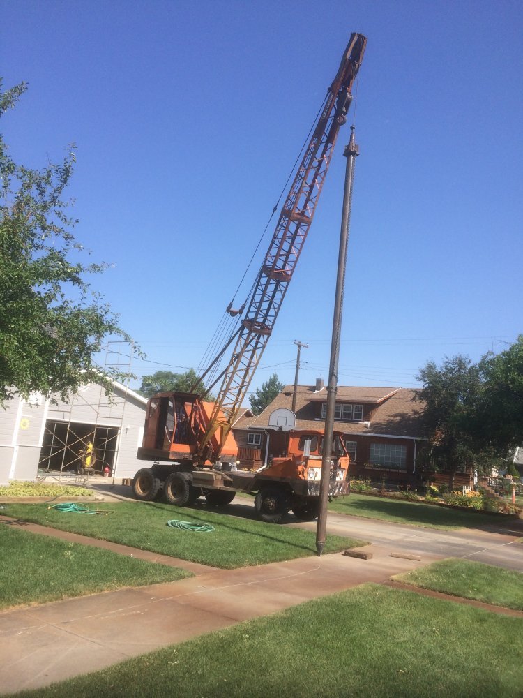

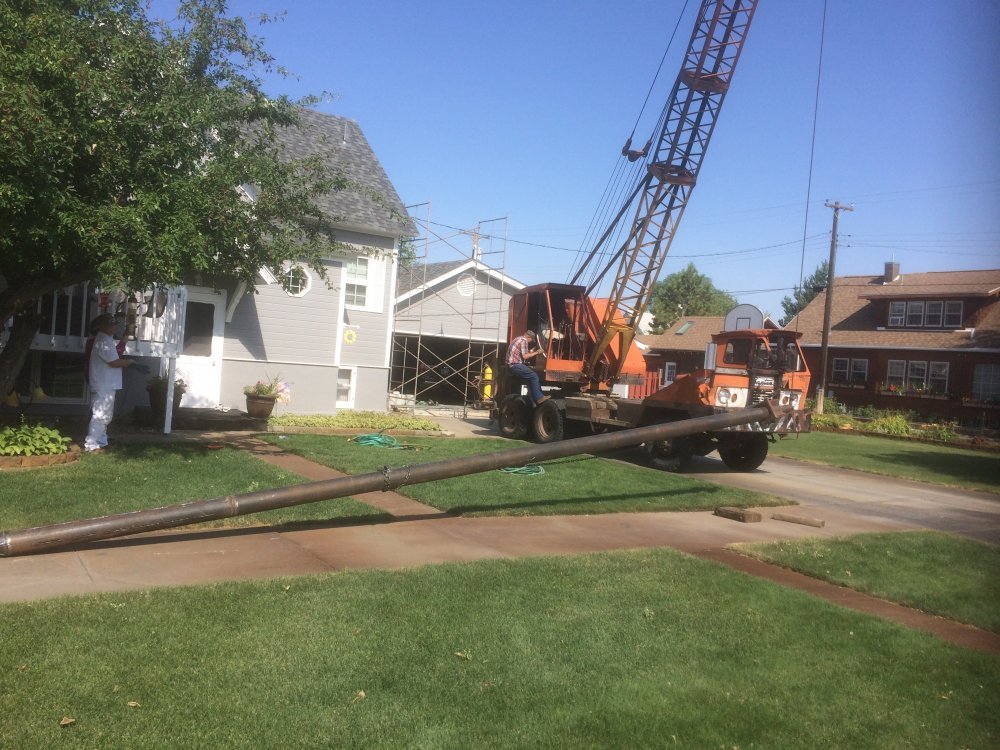

An old timer over here. He has a Bantam drag line He uses for driving surface water wells. About 25 foot deep.
I would take a 6 inch dia pipe, cut slots for about three feets from one end then bring the end to a point.
Strap it to the under carriage of My truck then haul it to location. He would arrive with his old Bantam, pick it up by the open end, set it down in a shallow hole deep enough so it would not fall over. Then He would unchain the top and set his hammer into the pipe. Then it was drive time.
I think He told Me the hammer weighed 600 pounds. Had a long round bar about three inch diameter, ten foot or so long, welded to the end of it so it would not pull out of the sandpoint.
14,849
33,065
Miles City, Montana

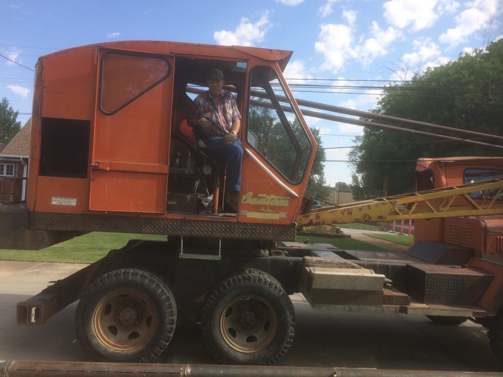

And Clarence, in the plaid looking shirt. Bantam owner/operator.
He was retired and wanted to stay that way but then the guy in the white painter clothes talked Him into one more pound. Donnie, in white, paid all the insurance and construction fees to get Clarence over to pound his well.
The Bantam now sets on the lot near where Clarence lives.
He still goes over and fires it up and runs the boom and cables out and in. Probably reminiscing on times past.

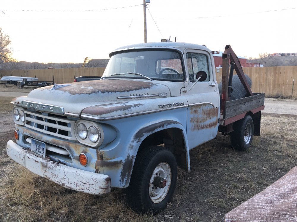

I have gin poles for the 59 W100 Power Wagon.
I had thought about a horizontal crank engine and one of them rope sheaves that when the rope has tension it pulls the load. Building a hammer with such a configuration and mounting it on the back of the flat bed. Run it through the gin poles then I could pound wells. See if Clarence would sell Me his hammers and be all set.
Would have to drive the sand point in two sections and weld the second half to the first half when its far enough in the ground to clear the top half of the gin poles. Could even make an even taller set of poles too.
Use the 6,000 pound bed mounted winch to stand the pipe on end into a post hole then set up the driver.
