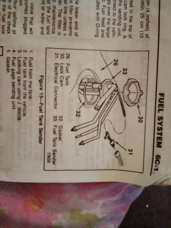

Vapor vent tube in sender.
Shop manual shows three small tubes next to the much bigger vent that connects to the filler by the gas cap. The two smaller tubes are supply and return. The slightly bigger one is suppose to be a vapor vent hose connection.

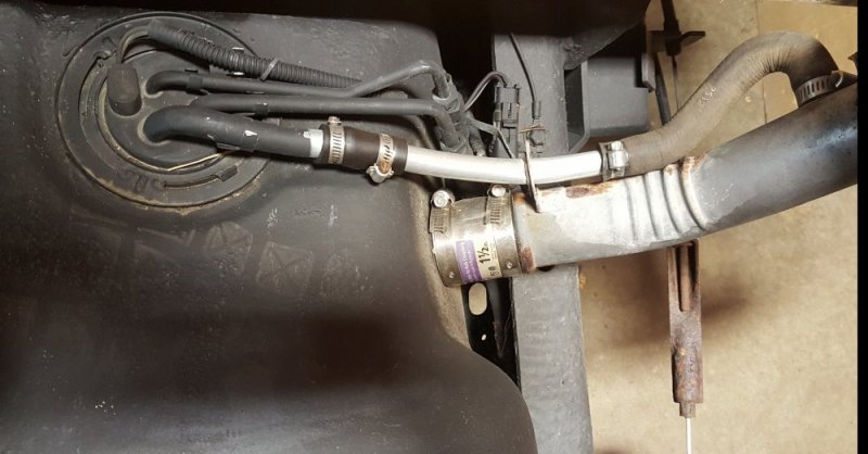

I have a hose coming out of the frame near engine. It has a a small hanger with a fastener hole in it by the end. I blew into it a little but then restricted. I guess it is the tank sender vent. No cannisters and don't see where it attaches to. I have to drive with loose gas cap or it'll backfire . I assume it's clogged now. Anyone know about it? Shop manual doesn't show
Im not sure it will help.
I have a 93 with the bed off. I can get you a picture tomorrow.
I believe that the actual tank venting is through the fuel tanks cap. Makes Me wonder if someone has installed a gas fuel tank or sender into Your truck.
I leave it loose. Easy to steal fuel though . That vent line is so big how could it ever get clogged? New diesel cap will cause sluggish performance and then backfire if tight . With flashlight and mirror I can get a glimpse of top of tank I think. I'll send shop manual picture as well
