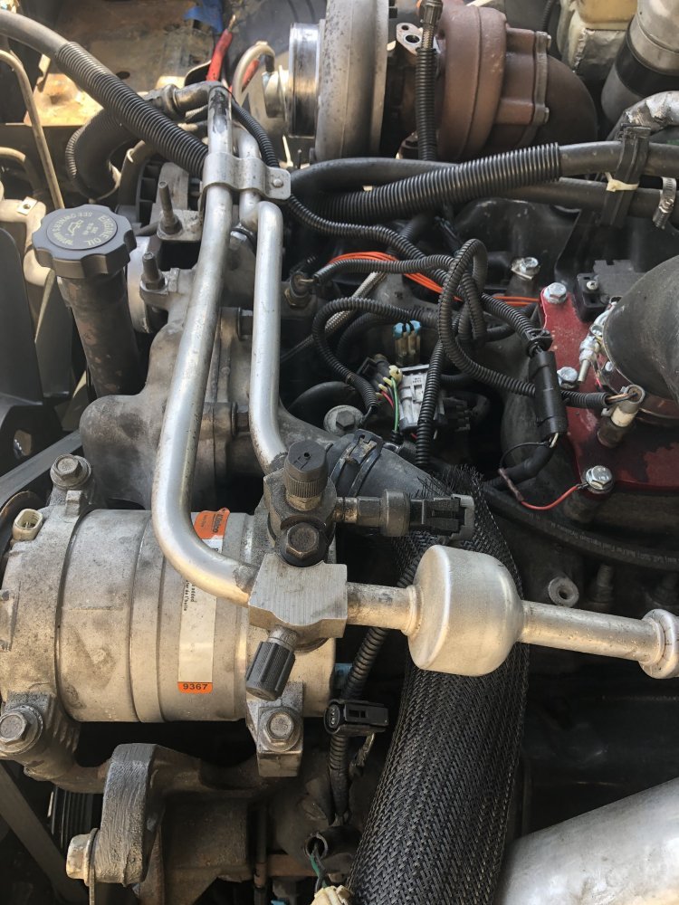

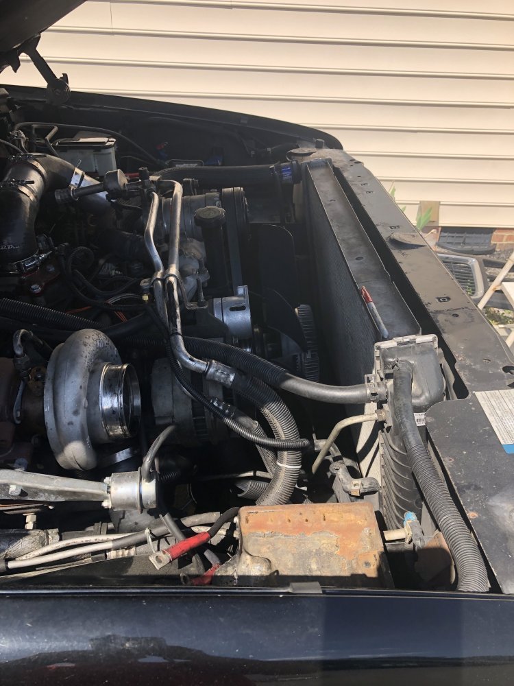

Not a problem.No sorry for the confusion. I need the replacement hose.
Look at the main bearing web portions of the engine block for cracks before loosening any main bearing bolts.I’m in the process of tear down to pull the motor. I’m planning a rebuild. Runs great but with 280k she’s kind of tired.
Yeah I’ll be looking for cracks for sure. Found some pro max heads seem like a good replacement. Haven’t torn into it yet.Not a problem.

I’ve been looking at replacement engines. Everything from military pull outs to optimizer and everything in between. Right now my top hose is hard and I’ve got weeping under the head. I’ll pull the pan and look for cracks. If it’s bad I’ll replace the head gaskets and run it till it gives.Yeah, at 280,000 miles I suggest pulling the pan in place and examine for cracks in main webs. If they are cracked just start looking for a younger engine or maybe saving for a new optimizer. If the mains are cracked - run it till she dies.

if I'm not mistaken Vintage Air makes aftermarket complete systems for most any rig. they also will custom make one for your needs, but $$$ talks LOL. there located down here in San Antonio Texas. there's a huge crowd around these parts with the old model t's and other old school rides!Yeah- places that do hydraulic and automotive hoses is probably best answer.
