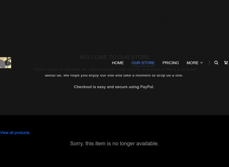

That's strange, I clicked the links above and it doesn't say anything about not being available... They are ready to ship and have been....
The Aluminum radiators are not available, they are on back order.... that's the only thing not ready to go...
It must be my browser because I checked with another and yes it is just fine. However; using the latest version of Firefox I see right now a much darker band over your page stating "Sorry, this item is no longer available" see:
